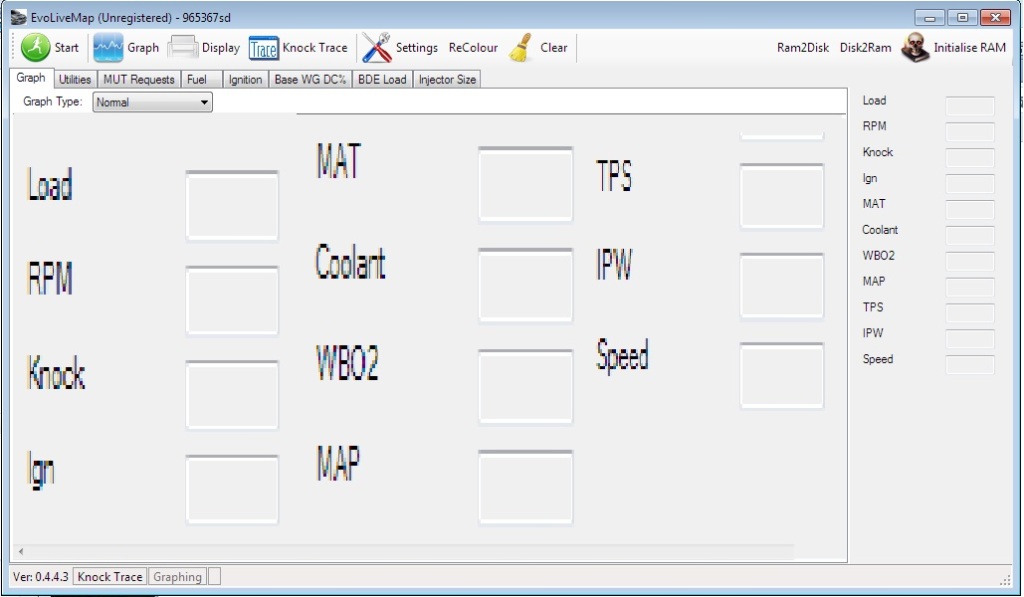

I'd also like an extra tab if possible as I use live map on my in car pc but have trouble pressing the tabs etc as my fingers are too fat hehe,
is it possible to make the tab lip as big as a button? also can you make an other tabs that shows the logged items as larger (similar to the list on the right ) but to fill a tab? I can draw a picture if that helps

fixed the bug for the ign map tracer
andy, what resolution is ur screen? i will see if i can make bigger tabs.
regarding the the logged item display. is there a reason u are not happy with it on the right side, is it due to screen size u have? to move that display panel to a tab... is slightly complicated... just thought of an idea.... but depending on time i will look into it

my screen is 8inch and the resolution if 1024x768 I'll take a screen shot a bit later so you can see

yeah I think the buttons are the right size, but the tabs could do with being roughly the same size. How do I register my copy?
the other tab I was on about i've made a picture see below
and this is the screen in the car

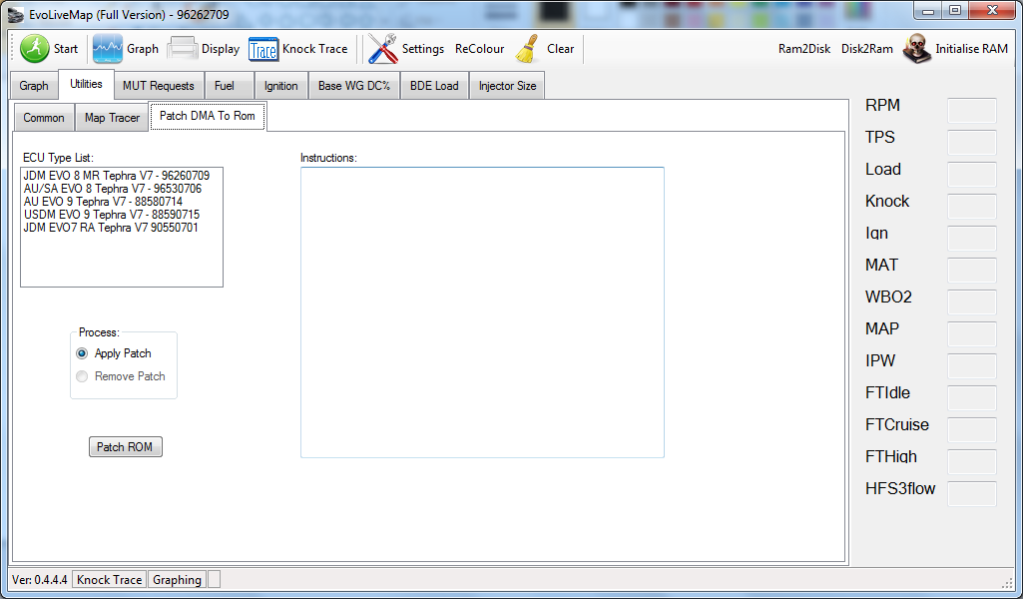

andy thanks, i will send u an email.
are u happy if i put them as an extra tab under utilities..i will try the new tab control, i can hide tabs in it apprently... which is a feature lacking in the microsoft standard ones
ahh yes will need to increase the font of the text boxes too
EDIT: here is something, let me know what u think. notice that the tab pages are bigger is size now. its till 1025x600 resolution... and no i havent moved the text boxes to a new tab page... will be easy enough to do.
