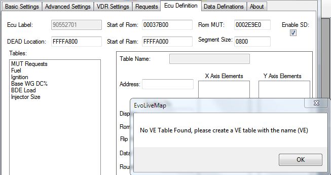

I have 90556701 SD loaded, logging the and live map is fine.

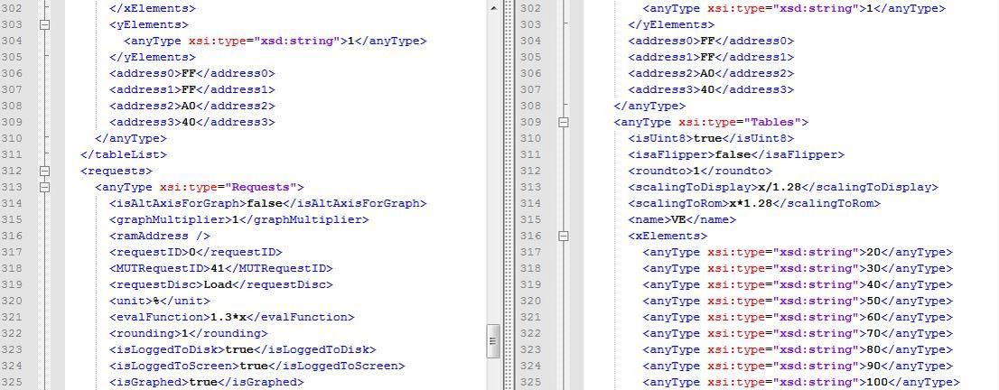

But there is an issue with loading the VE table to the live mapping. I have selected 90556701DMA ROM and live xml. When selecting the Enable VE option from ECU definitions tab, EML give me the error, "no VE table found, create a VE table" The VE table actually exists in Donners original 90556701 xml, but it looks like ELM is deleting VE section of the xml.
Left xml in EML settings folder, right donner's origional
Attached Thumbnails new live map app-vetablegone.jpg   new live map app-sdfail.jpg
Just tested reading VE map with live on the bench ecu and it worked (also map tracing as function of map worked) but not perfectly, there is something strange when I select Enable SD and program gives some error message. This happens also with 9653 3d VE version which is more commonly used with live and prooven to work as we used it a lot last summer (not with Enable SD function though as IIRC it was not available last summer yet). For me it did not remove anything from xml but like said some error essage was given.
Did you try to tune VE (and other tables) with live and it worked fine and problem is just tracing (that is what Enable SD does)?

Well this is odd, reloaded the xml this morning and selected the VE enable and all is OK. I'll test the VE tracing later.

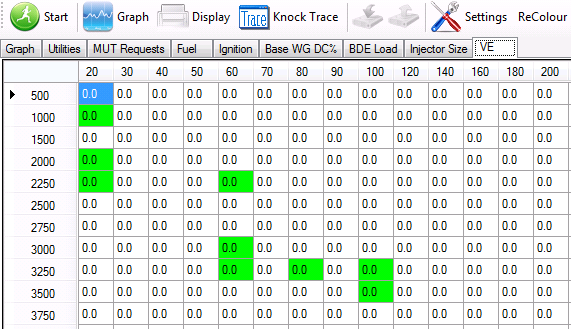

Andy in ur case mate, can u retry VE tracing. but first goto "ECU DEFINATION" tab in settings and click "Enable SD"
i just tested and it seems to work for me. can people explain what the problem was? i have run two different files from two people through ELM.
what VE tracing requires is:
Enable SD (checked)
MAP (request in kpa)
Sample log:
sample map trace output:
