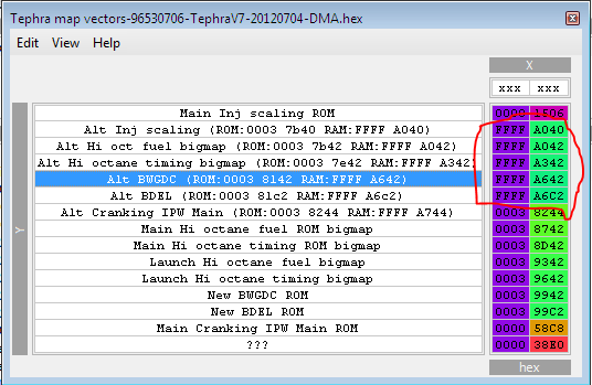

96532706 works great. I've just finished tuning my USDM 8 for cams, turbo, FMIC and injector upgrades. The live map changes to WGDC, fuel and ignition halved the time it takes me normally for a complete MAF based re-tune.
*Suggested addition to your documentation for completeness* - I had to make changes to the Tephra map vectors in the patched ROM. These need to be pointed at RAM otherwise changes made in LiveMap do not get written when you click Write to RAM. (see the pic below) It's not obvious for anyone using this for the first time.

Carl those should be patched when you use my program to patch your file. I am very happy you found the program useful.
