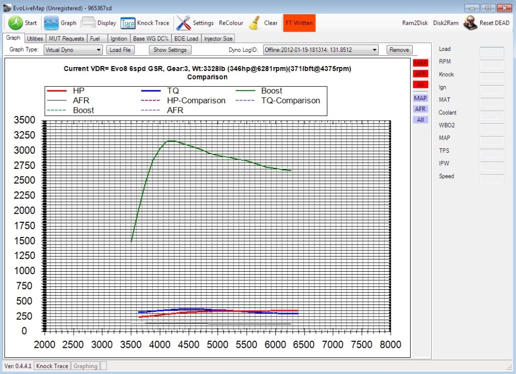

I log my boost as kpa so this is what I end up with as a graph, is it possible to have these scalings adjustable? and yep changing the car by the vdr settings table but it doesn't seem to effect the graph
thanks
Andy

andy... i will have a look... hmm forgot about kpa ppl (as i do PSI) i might have to make some adjustments in the next version....
i like it, that ppl are now starting to use it and finding bugs... lol

Lol I tried changing maps....could replicate..the graph said evo 7...when I normally have 8 mr.
Three other I will put a toggle. In next version.
