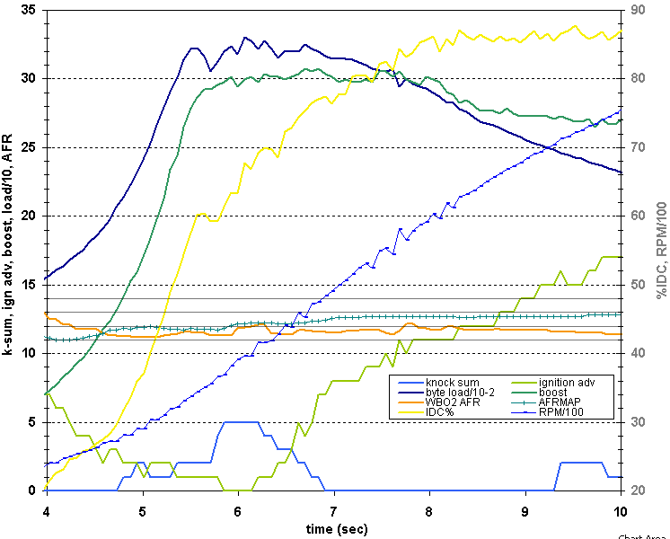

Originally Posted by Jorge T
if that log is displayed in a line graph i bet the rpm plot will have low spots and the rest are clean.
Yes, RPM is the parameter that's acting up. Below is the data vs time.
Originally Posted by jhanksevo
its my vehicle and im at 102000 miles. I can say during that particular log it felt and sounded like a misfire but the odd thing is the plugs i put in like i always do br8es are fresh maybe 250 miles and i gap to .023
Ah. Since this isn't happening at lower loads, it sounds like this could be a simple issue of breakup. The lean fluctuations at the point of RPM flutter suggest this as well. You might want to try gapping down the plugs to something tighter (0.020"?) and relogging the last tune. Let's try that before going down the dying CAS road any further.

I can see the AFR blips and timing in that area is bit jumpy too, looks like it is breaking/misfire up in those areas...
