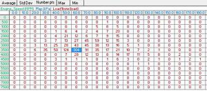

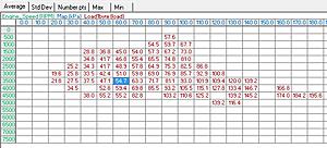

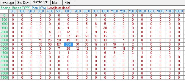

Wouldnt it be better to lock in one of the 2d tables so that you dont have to mess around with two tables and a fuel map to get the tune right?
I was looking at Bigric's log and l2r's suggestion for bigric's Map VE. I noticed that when I set the rpm on the Y axis and kpa on the x axis and populated the graph with 1byte load averages, the results were very very close to what l2r suggested, but in less words.
Since the map VE table needs kpa (known constant) and load (known average), wouldnt this be easier to lock in this 1 table, and then only adjust the RPM VE and fuel map for the tuning?
i just got done adjusting my buddies car and essentially thats what i did. Did the log, noted the adjustments that needed to be made via the mapve table, adjusted those and then made the changes in the rpm table as well, and she was right on.... and then its fuel map time

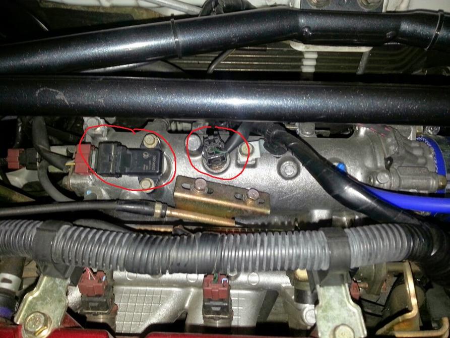

Did you know that JDM evo IX came with MAP and IAT?
Guys I am actually trying to get some information-help about speed density conversion on my jdm evo 9.
As you can see in the picture below my car came with a map sensor (3bar) and an IAT from the factory. What I want to know is, if I wanted to go on SD route could it be possible to tune the car as it is?
I also bought an Omnipower 4bar sensor, can the omnipower be tune with my stock IAT for SD?
you can use either map sensor and your stock iat sensor
