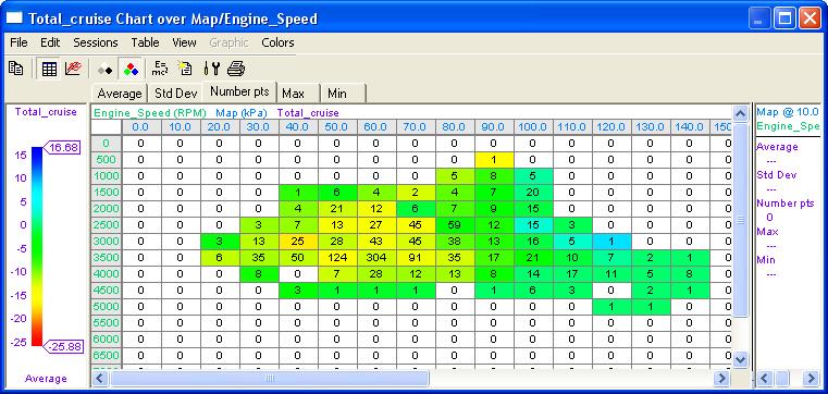

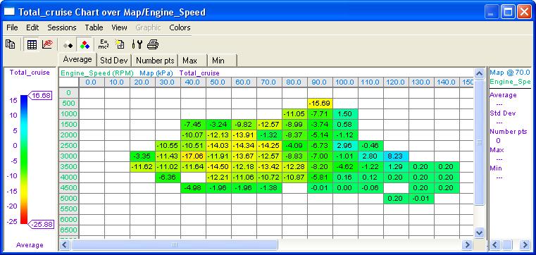

OK, so I received the logs from bigric09 and put them into LogWorks to analyze the fueling using:
LTFT Lo + STFT for idle
LTFT Mid + STFT for cruise
The charts below show the results for the idle and cruise logs:
Idle - average
Idle - number of points
Cruise - average
Cruise - number of points
As you can see from his idle charts, he idles in the 50-60 map range at around 1000 RPM. The rest of the points for this chart are just extraneous data. We care about the cells where the most data points fall. So, looking at the chart, it looks like he needs about a -11% correction in fueling at idle.
The same goes for cruise, so we will concentrate on the cells that have a larger number of points, not the outlying cells that were hit a few times. We want the corrections numbers from the cells with the good sample rates. This also helps out in averaging transitions in throttle, etc. So, looking at the chart and the meat of the data, rough corrections for a few areas are as follows:
50-70 map/2500RPM needs -14%...50-70/3000 needs -12%, 50-70/2500 needs -13%
80 map - 2500/-4, 3000/-9, 3500/-12
90 map - 2500/-7, 3000/-8, 3500/-8

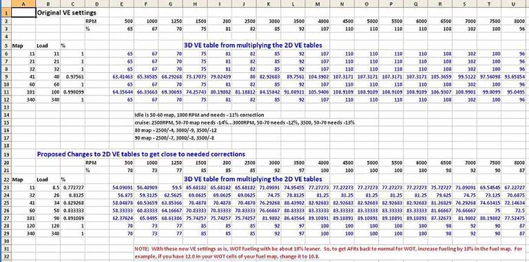

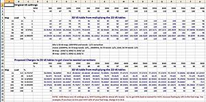

OK, so now we have to see what the 3D VE table looks like based on the current VE tables. Bigric09 posted his setting on the page before in post #377.
I created an Excel spreadsheet to multiply out the 2D tables to create a view of the 3D table based on his settings. Then, below that, I have the same thing, but with new proposed settings, where we can change the 2D VE tables to arrive at the corrections that we found in the post above:
What I like to do is scale the RPM VE so that the highest value is 100%, which should be somewhere around the midrange, then taper off from there to either extreme.
So, from there, I started to adjust the map VE values to accomodate the corrections that were needed from the logs above. For example, his idle needed about a -11% correction. Remember, his idle was around the 60kpa/1000RPM cell. So, looking at his original VE table, that cell showed a VE of 67%. To make a -11% correction to that, we want to have a value of .89*67=60%. The values I came up with for now to achieve that was a map VE at 60kpa of 50 and an RPM VE value at 1000 of 73.
I then used that same method to go through the entire chart, trying to get as close to the corrections needed as possible. Again, it's not easy with just 2D tables, as changing a value in the map table changes an entire row in the 3D table and changing a value in the RPM table changes and entire column in the 3D table. So, when you change one map value, you will most likely have to readjust many RPM values and vice versa...change one RPM values may lead to changing several map values. This is where you may go nuts.
This the reason why I advocate for a 3D VE table. But anyway, just use that method and then notice the trend in the table and try to blend the transitions...ie towards 100-120 map the VE starts to rise from the relatively flat spot in the cruising range. Also, as RPM increases towards the mid-range, the VE increases, and then falls over either side. So, for now, bigric will try out these new settings and we will keep tweaking from there.
One important note about the new settings and this car. The values that I chose for the VE tables will cause the WOT fueling to be about 10% leaner in this case. In talking to bigric09 over email, he said that it was too rich anway, so it may turn out good. But, anytime you are tuning VE tables, take caution on the first time you are going WOT, just in case it's leaner than you expect. If so, you can either use the RPM VE to tune it back to normal, or use the fuel maps. In this case, I would recommend using the fuel maps, and use the RPM VE to adjust for further mods in the future.
Hopefully this helps a few people out.
Eric

im about to flash this and go cruise and idle again...
what my question is... what was the determining factor that in needed to lose 11% ? Im assuming you were looking at the fuel trims and seeing i was neg 11 to 12, and those are the cells i cruise or idle in therefore we are taking 11 percent.

and... you are only showing 7 values on the map ve table and there are 8.
