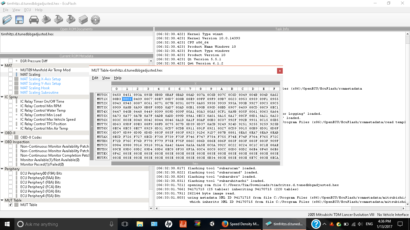

Do i have to manually fill the whole table with the values in your table ? using 2d78 address ?

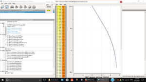

I tried the above procedure and made a new scaling.
when i select the new scaling the whole right column shows values -0

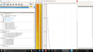

Sounds like you made an error in setting up the new scaling. Post up a screen shot so I can check it for you.
Have a look sir.
Please confirm the address used for scaling.
I tried the explained procedure.
Damn i cant get it right...
Any alternative would be appreciated.

Your scaling looks good. What is the problem you are experiencing?

After i created the new scaling it would appear,
i select it from the scalings but the correct numbers dont appear instead i am getting all -0
Using address 2d78
Anything else i can post for you to display any specific details ?

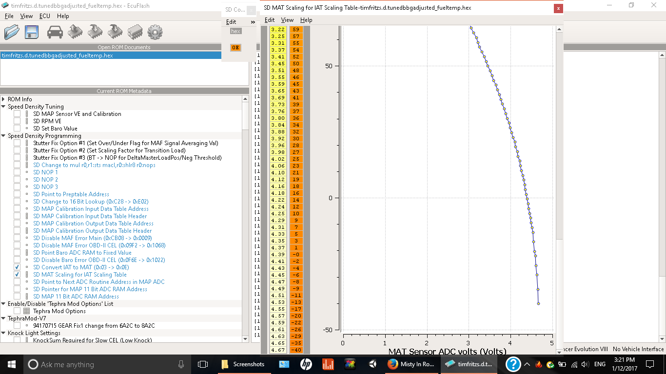

Two things;
1. You are missing the 96530706.xml from your metadata directory. It is requried or ECUFlash will not display all the tables. Download and add all the files in Tephra v7 xml pack to your metadata directory so you have all you will need for tuning.
2. You have correctly defined the new TempFueldegC scaling, it's just that the table has no voltages or temparatures in it.
Here are the voltages (GM IAT calibration) so you can cut and paste in the first column:

Thank you sir .
I do have 96530706 xml but i guess it has some missing data.

Old Jan 12, 2017 | 12:38 PM
  #41
redSLed's Avatar
Joined: Feb 2010
Posts: 139
From: Bethlehem, PA
I think I've finally just about nipped this in the butt! I've attached screen shots from my 94171715 SD V7 Phenem rom.
SD Convert IAT to MAT is set to 0x0E
The 139 element table: SD MAT Scaling for IAT Scaling Table values are (in def F and volts ADC):

Under MAT, my 121 element MAT Scaling table values in def F and Volts are:

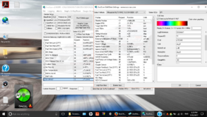

In Evoscan, I am logging air temp from request 3a with the equation for deg F at x*1.8+32 and I'm attempting to log SD MAT/GM AIT from request 11 using x*1.8-40 to log def F. From what I understand logging request 11 is scaled data the ecu refers to for fueling.
I'm not sure what value I'm supposed to log at request 11, but airtemp is right around ambient at 59 degrees but fuel temp is showing like 75-76 degrees with just the ignition ON. I haven't started the car yet to see if I will change or how it will change but I think I'm finally very close after hours and hours of reading here!
Attached Thumbnails Speed Density MAT-screenshot-26-.png   Speed Density MAT-screenshot-27-.png   Speed Density MAT-screenshot-28-.png   Speed Density MAT-screenshot-29-.png   Speed Density MAT-screenshot-30-.png
Old Jan 13, 2017 | 04:48 AM
  #42
WytWun's Avatar
Joined: May 2010
Posts: 51
From: Canberra, Australia
What addresses are in the MUT table for the requests you're trying to use?
If the MUT table addresses for requests 11 and 3A have not been changed from the base 94170015 (I don't have a copy of 94171715 to check, sorry), MUT 3A is logging raw ADC input for the IAT sensor (i.e. Volts) and MUT 11 is logging the scaled output of the 139 element map at address 9a96 (which is normally the IAT Volts to temp scaling map).
Old Jan 13, 2017 | 08:23 AM
  #43
redSLed's Avatar
Joined: Feb 2010
Posts: 139
From: Bethlehem, PA
Thanks for the feedback...these are the kind of suggestions I'm looking for. I'll check the mut table tonight after work. If that seems correct then possibly my mat scaling for iat scaling table (139 element) needs adjusted or my gm ait could be malfunctioning. I do have a spare new senor here I could swap in to test the logged data against what I'm getting now. I'll report back later with some info for you. Thanks!
Old Jan 13, 2017 | 08:39 AM
  #44
redSLed's Avatar
Joined: Feb 2010
Posts: 139
From: Bethlehem, PA
So is what you mean is that MUT 11 should have the address 9a96 from the 139 element table? Without looking I'm almost certain that's not the address that's currently in there because I've looked over that table and nearly everything starts with an '8'. Lemme check and get back here later.

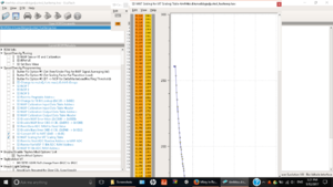

Old Jan 13, 2017 | 01:43 PM
  #45
redSLed's Avatar
Joined: Feb 2010
Posts: 139
From: Bethlehem, PA
Here is a shot of my MUT table. As you can see, MUT11 is not the address of 9a96 and MUT3A is the address 883B. Which table and address should MUT3A come from, the other address value in the 139 element table, MAT Sensor ADC volts, address 9b2c?
