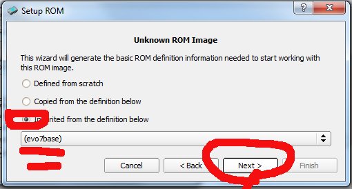

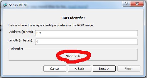

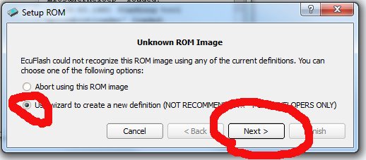

Then prepare to be schooled on how to do it yourself. I couldn't remember the exact steps so i just made ecuflash unrecognize an existing rom.
STEP 1) Open a rom to recieve this Dialog
STEP 2) Make sure you use the wizard to create a new def since the other option just closes it.
STEP 3) We are going to inherit from the evo 7 base you could use the evo 9 base if its from an evo 9 you get the idea i think
STEP 4) Use reading skills to extract the rom ID labeled in red in this dialog. You could cancel the process at this point since we just want the ROM ID not really to create a xml file.
Attached Thumbnails unknown rom image-step-1.jpg   unknown rom image-step-2.jpg   unknown rom image-step-3.jpg
