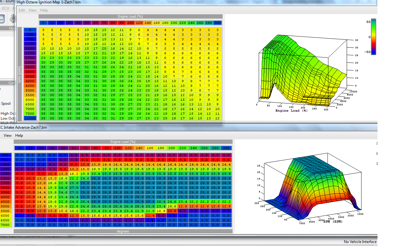

There are a lot of UK companies that have used Titanium compressor wheels. Also you could send your turbo to the UK companies that converts Mitsu turbos to dual ball bearing. It would be like having a FPRED spool faster than a evo 8 turbo.
Sometimes porting and opening up flow (i.e bigger IC) slows response and "spool". Focus more on how quick your car revs out other than full spool by **** Rpm. TQ moves the mass HP keeps it going. Depending on your mod timing is what will achieve what you want.
Here is a Evo 9 91oct 28 psi with a 50/50 injection timing map. This thing is FAST! This car still using Lean spool which I use on every car I tune.
