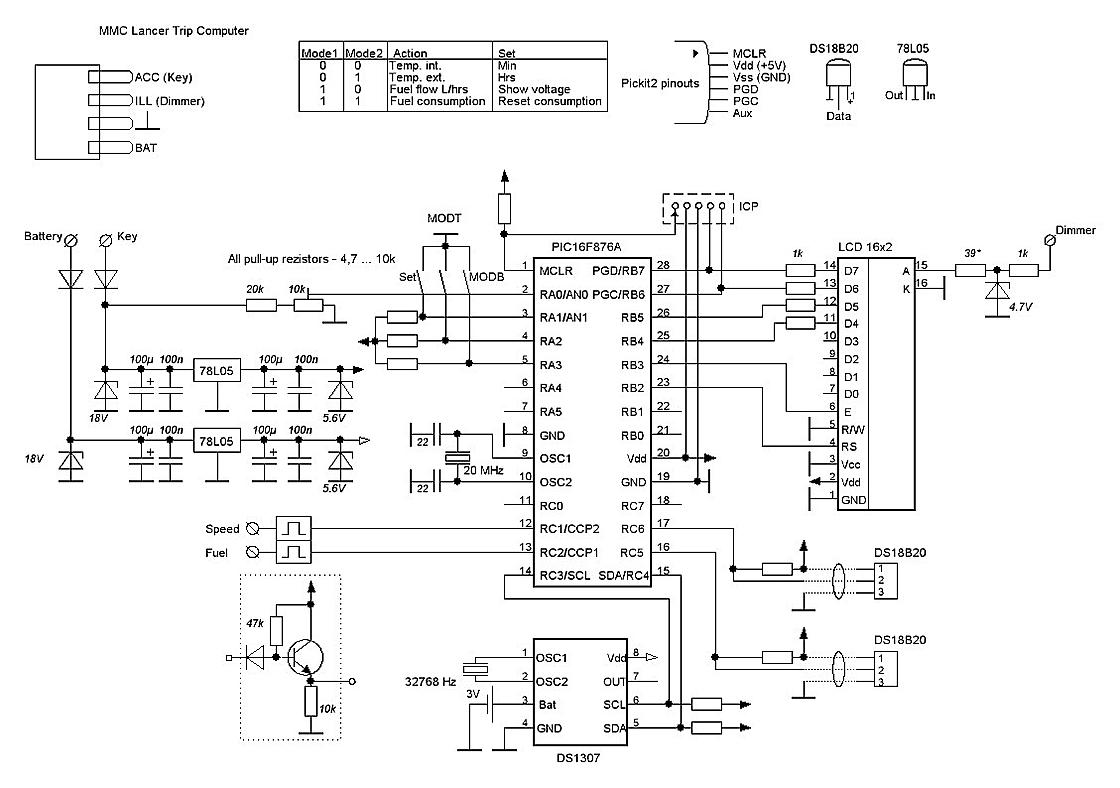

As we all know we need free OBD socket for tuning purposes, therefore I have been
looking around for some standalone trip computer that would just plug and play.
I have come across trip-computer from Serg Electronics (Russian).
They have been able to provide one for me with English interface, maybe they can do it also with mpg instead of l/100km, which is frequently used unit in Europe.
What I like about this approach is that you just replace your clock and wire few wires. I have been using it for almost a year now without problems.
Anyway accidentally I have found a schematics that does the same thing but has to be programmed so I have thought it is worth sharing.
MODS, please rearrange if it shall be placed in some other sub-forum, I post mainly here so I thought it will not hurt.

OEM clock connector is plugged directly without modification.
So battery, ground, dimm and illumination are out of question.
There are three additional wires IIRC to be crimped on the original harness
1. injector signal (any of the four) EVO7 ECU PIN 1/2/4/5
2. vehicle speed signal EVO7 ECU PIN 86
3. fuel level signal - wire running from fuel gauge unit PIN1 to combination meter PIN 51

I believe schematics above says it all except for pulse signals scaling. Should not be that hard to figure out with oscilloscope. It was either AVR or PIC based (cant remember now) so reflash should not be that hard.
I am really sorry that I cannot help you more, but I could not find firmware for the schematics above
Maybe some of russian members (e.g. AIK) can arrange imperial units English UI group buy for you.

Looking at your schematic and their docs, it looks like the answer is no, but it also looks like they haven't done a firmware update since 2007 anyway, so it probably doesn't matter.
