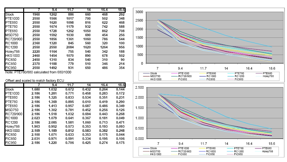

I just bought a set of 780cc pte injectors, was hoping someone can give me some latencys to start with. thanks

I find that PTE overrates their injector size, so I would start with an Injector Scaling of 680cc and the latencies are listed here:
http://www.sr20deracing.com/EVO/inje...ncy_master.xls
or here:
http://docs.google.com/fileview?id=0...OTY4MDc4&hl=en
I personally think the values in that link are a little low, but are a good starting point. For the DSM's I generally add >300uS to each of voltages.

I dont have excel on my laptop so i cant open the aem latencys, already tryed lol.

Try this:
http://www.dsmchips.com/Files/evo_latency.jpg

Injector Scaling Size = 696
Latencies =
3.312
2.04
1.296
0.984
0.792
