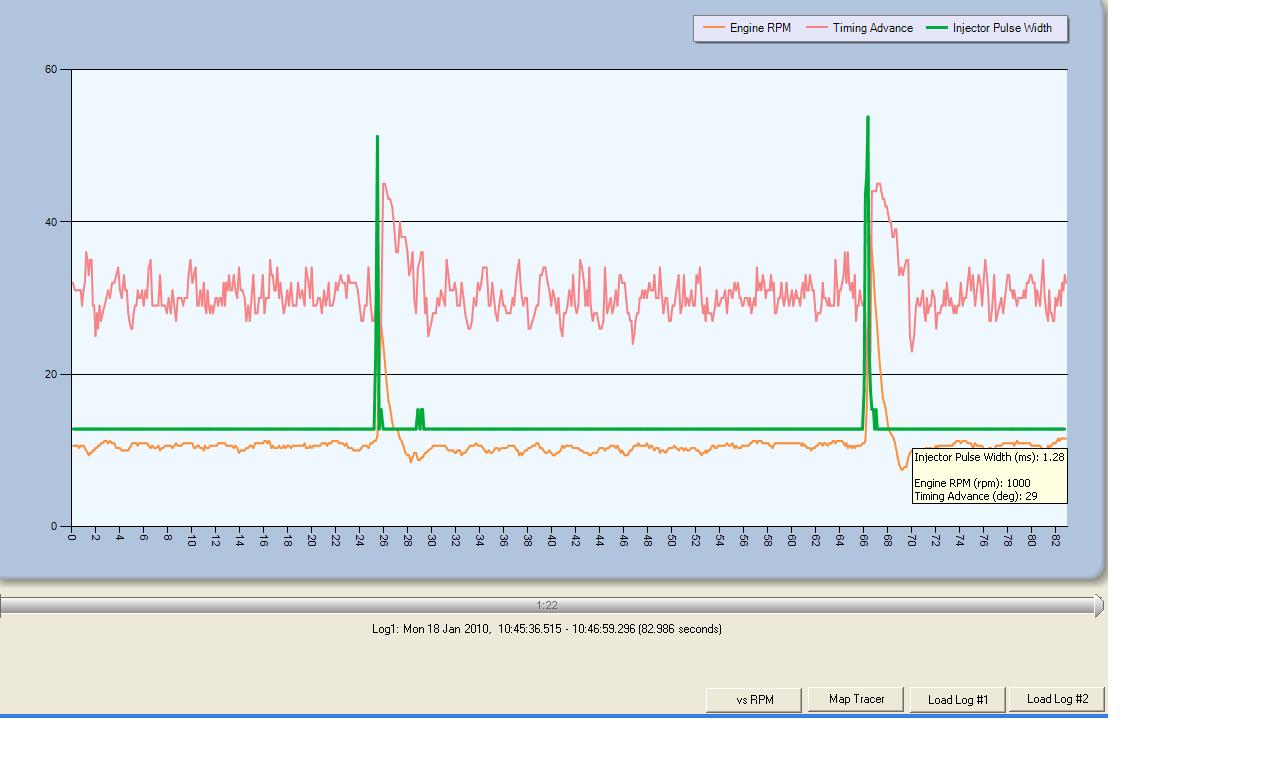

Yes, logging MUT29. Here is a screenshot.

Might be interesting to log 2-Byte just to make sure it is varying and you are not hitting some minimum pulsewidth.
Probably not the case though and it is varying, just not enough to hit the next lower step.
Are you finding the RPM and MAP VE table you are using provided good off-idle driveability and AFRs but then idle is extremely rich?
Or is the car rich in general at low loads and engine speeds?
My car on the IDC1000s has AFRs slightly on the lean side just of idle, but it stills wants to idle insanely rich. I used the MAFComp table to pull out a bunch of fuel in the idle airspeed range.
