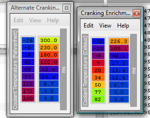

<table name="Cranking Enrichment IPW Adder (Main)" address="52b2">
<table name="Coolant Temperature" address="6ff8"/>
</table>
The def for the alt map is different.....the one above is the normal 8859 which is already included in the stock xml/bin
Here's my IPW tables and I have NO issues with cold starts what so ever.
