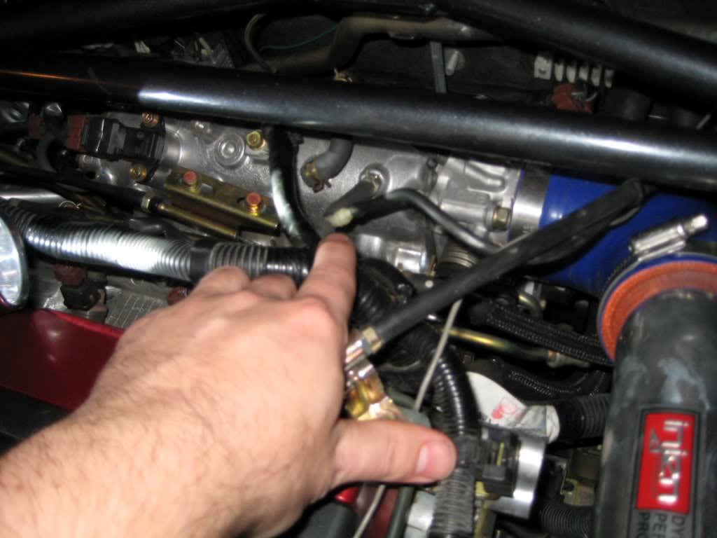

appauld: had asked if I had a hose from the BOV, that ran to the IM. I do, it runs to the valve cover (metal bar on the side of the valve cover) that runs to the IM, then is T'ed off w/ a line that runs through the firewall... Not sure whats w/ that, other than I have the EGR removed and a block off plate, and he said he was ting off somethin. But I dont think that has anything to do w/ that.
heres a couple shots of what Im talkin bout...

I would assume that it is T'd there for the Boost Gauge. I do not see Zip ties on the lines. I recommend zip tieing them to help avoid leaks.
I would also recommend using the vacuum line going to the fuel pressure regulator as the source for the boost gauge. Then run a single line to the BOV.
It appears that the BOV has been crushed slightly too. Could be that it is crushed a little too much and does not open as well as it should under partial boost conditions. Try running a single line to it to see if the condition improves.
I found that if you are boosting higher than stock, that you should also adjust the wastegate actuator tighter as well. For the Wastegate actuator....run a dedicated line directly to the boost controller and then another dedicated line off of the J pipe directly to the boost controller. This will allow the most consistent boost control.
I think I have some zip-ties laying around somewhere, I'll get on that.
Yes, the BOV is crushed, but just right, as I have minimal flutter @ partial.
I'll see what I can do about the wastegate, but most likely gonna need some help w/ that 1. (I sometimes wish I didnt have that POS undertray on, and had the beatrush peice) The wastegate was tightened a couple turns when I had the hotside ported, but maybe needs a couple more?
The BCS lines are routed as u described. Done @ an evo specific shop. Guages were not...
Dumb questions: Best spot to get some vac line? Autozone?
So there is a line connected in 2 spots next to what I believe is the FPR (left hand side of IM, next to the 3 bar map sensor) Im assuming I could use the "t" for that, but would still need to locate where the boost guage connection is, and run a new line from there long enough to reach the FPR? Or is there a extension of some sort, like a "t", rather than running a new line? And then just get another new line for the BOV/valve cover location to the IM?
Thanks for the tips Paul! Youre always very helpful!

Yeah, Autozone will have vacuum line. I prefer to use fuel line as vacuum line because it is more firm and won't collapse and does not kink as easy. You are using fuel line on your BOV. You can tell because the line has braid inside it and you can see the hex pattern.
Just start with all fresh lines. T's happen to get brittle over time and can crack so I recommend replacing them too.
I also noticed you have all worm screw style clamps. You might want to give them a once over and tighten them up. Worm clamps have a tendency to loosen over time (at least from what I have seen).
You can see the goal here is to eliminate the potential for boost leaks and vacuum leaks. Once the mechanical stuff is taken care of we can then move on to the tune.
thanks for yet another tip! I'll get some "fuel line" and re-route things... Am I correct w/ the location of the FPR? There are 2 lines that connect right next to each other, there, and looks like I would need a "t" for that. Or is there a better method? I had a diagram of the entire IM/TB/sensors, etc., but when my comp. **** the bed, lost everything... and as u can tell, I wasnt exactly wrenching on any of my previous vehicles... {angel}
I agree w/ ya, as I had just replaced this very coupler, w/ a new 1 (thicker ply ETS) and tightened the hell out of it. I'll go over em all again... If it happends again, I'll get some t-bolts clamps...

The line for the FPR is on the left side when looking at the engine. It is behind and slightly left of the PVC valve that comes off of the valve cover. The FPR is a small circular device that is silver in color. It has one vacuum line coming off of it that in stock form is wrapped with plastic. I would T in there for your boost gauge.

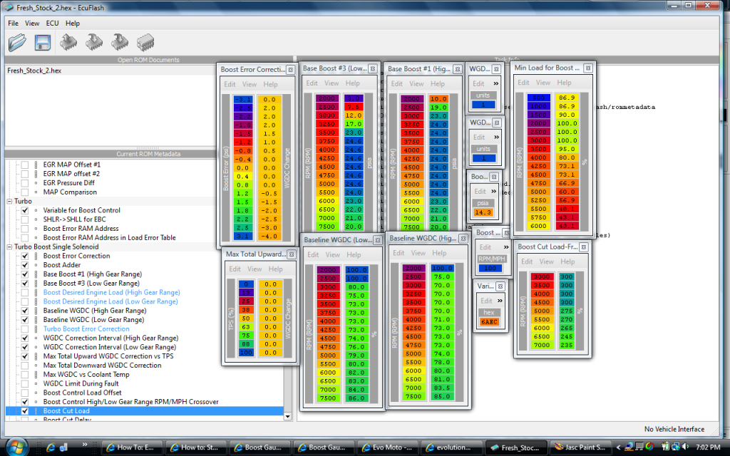

I figured I would just start w/ tightening the arm a turn or 2, and go from there, but came across that thread... I should probobly get the fuel/vac lines done first tho...
I have thought about swapping an MBC on, but I think the prob. is either BOV, or wastegate related. I think Im experienceing either wastegate flutter, or BOV leaking causing revision of airflow back into the turbine causing compressor surge, during spool. Although, it seems like, from what I have read, compressor surge happends after peak boost, so possiblt BOV... IDK But just my "guess" from the info I have gathered...
heres a shot of my "stock" boost tables.
