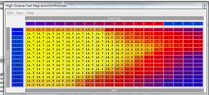

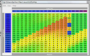

Can't flash or read the ROM from your ECU - Start Here!-ignition-map-copy.jpg
hi....
I have two problems with ecu flash and my tuning stay freeze.
First the pop up window with vehicle type is empty.
Second I download the ecu image with other laptop but when i open the image with ecu flash some values are 'I think' are not correct. Take a look on rpm and load engine values.
RPM: 395, 461, 2559.., 1364.., 2559...,1406..., 105, 0, 39,78,117,156,195,234,273.
LOAD: 41,43,47,50,53,56,59,62,66,69,72,74,78,80,204...,1 09...,204...,112...
ecu id: 96260007
Thanks Haris.
