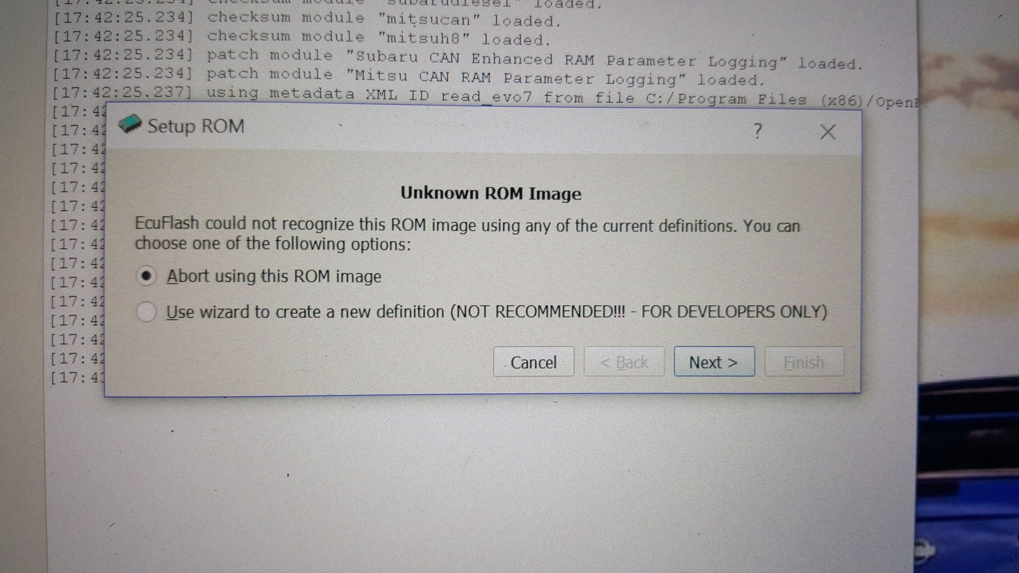

Originally Posted by Jhova5
Sorry guys I'm new to this ecu flash, I have got it to work but when I read the ecu I get this unknown rom image I used the ( wizard to create options ) I pick the best to my 05 evo8 rom and still can't read it have a rom ID 84185028 help
I am having the same problem - I get the 3 options you see (this is a previously tuned 2006 Evo IX MR.)

[10:15:24.194] sending init sequence 1 (0003)
[10:15:27.485] sending init sequence 1 (FFFF)
[10:15:30.777] sending init sequence 1 (F0F0)
[10:15:33.554] no response to any known code
[10:15:33.569] interface close
Thanks!
I read the Help-Thread, but all this should be like written.
Bump, any other ideas?
