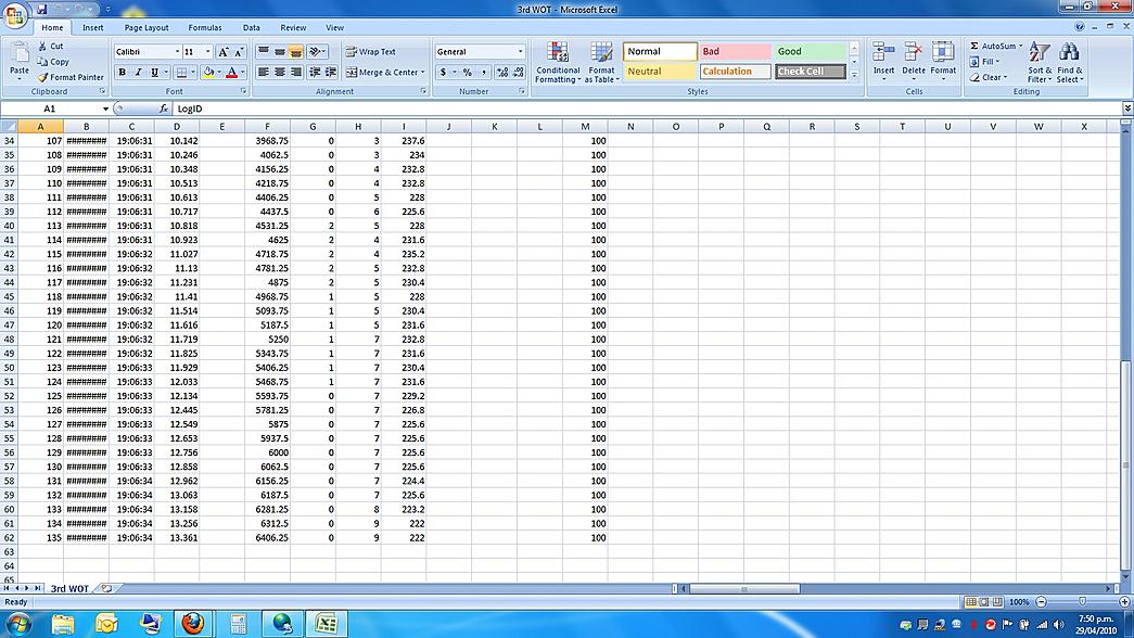

your timing isnt low! I am running around the same as you
see attached csv for a 3rd WOT, this is running 23 psi tuned to 12.5AFR on spool up, 12 AFR peak, 11.1 AFR at redline on our 95RON petrol (about the same as your 93 octane)

my car in std form was getting knock counts of 13-18 at redline and 10-12 at peak
