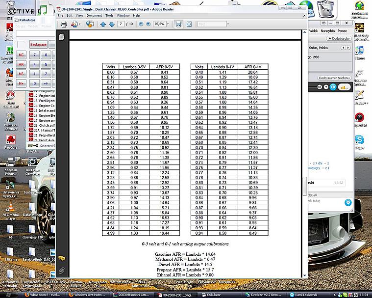

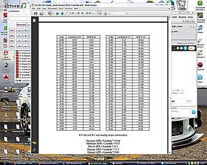

Ok back to asking dump questions -is there any way to test my wideband sensor?
I got it from bay of e and its giving me weird readouts
AEM 30-2301 setup in rear o2 ,mutt12 I left function setup as X
I've done scaling according to aems pdf for this unit but readings look weird
(0.03702*x+10 my scaling came to)

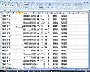

knocks a bit should I move timing or fuel map?
not the best log tps not all a way down but is consistent with 100 tps
