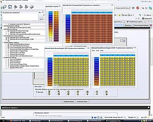

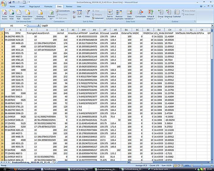

ok I got another problem ;/
I can't setup V7 to go over 159.4 load (11Psi) what I have to change to go 23 psi?
Old Jun 19, 2010 | 03:40 PM
LGshow19's Avatar
iTrader: (51)
Joined: Feb 2010
Posts: 1,640
From: San Antonio
No enough info...
Old Jun 19, 2010 | 03:55 PM
Keller's Avatar
Joined: Aug 2009
Posts: 24
From: london
what tables in v7 I got to change to go over 11Psi, looks like there is some boost cut setup in v7 so I cant go over 11Psi even I got desire boost setup to 18Psi
Old Jun 19, 2010 | 04:11 PM
LGshow19's Avatar
iTrader: (51)
Joined: Feb 2010
Posts: 1,640
From: San Antonio
I can't see the tables cuz I'm on my phone..
But did you remove the up the boost cut load..?
Old Jun 19, 2010 | 04:18 PM
Keller's Avatar
Joined: Aug 2009
Posts: 24
From: london
nah boost cut load is setup
3000 235
3500 235
4000 230
5000 230
5500 230
6000 230
6500 230
7000 230
can You tell me what should I putt in?
Old Jun 19, 2010 | 05:26 PM
LGshow19's Avatar
iTrader: (51)
Joined: Feb 2010
Posts: 1,640
From: San Antonio
You should set the values to 300 or like 280 if you want to be safe... Even though I highly doubt you'll hit those loads if you are close to stock...
What are your desired WGDC for sea level, etc...?What are All your values for adjusting boost via ECU controlled boost?
Old Jun 19, 2010 | 05:44 PM
Keller's Avatar
Joined: Aug 2009
Posts: 24
From: london
WGDC in gears are still 0.0 I don't know what shuld I stick in....Shame You cant see my logs ;/
I set boost adder to 14.5 but don't make no difference
Old Jun 19, 2010 | 05:47 PM
Keller's Avatar
Joined: Aug 2009
Posts: 24
From: london
Values for adjusting boost via ECU controlled boost are stock V7 , I loaded today and I'm trying to work it out (with no luck so far ;] )
Old Jun 20, 2010 | 08:22 AM
evo8426's Avatar
iTrader: (27)
Joined: Jan 2006
Posts: 4,248
Likes: 9
From: Charlotte, North Carolina
you should try tuning the "Main Map Boost Control Settings" in the screenshot it looks like youre working on the alternate map settings. See if that will fix your problem since the car runs the main settings
