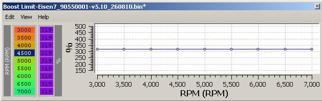

I'm a bit confused as to why you think my Boost Limit scale only goes to 4000rpm though? When I open the 'Boost Limit' setting in EcuFlash, this is what I see:
Set at 319% from 3000-7000rpm. I wonder why you're all only seeing it to 4000rpm. Or are you talking about something different? Let me know if I'm looking at the wrong thing here - I'm fairly new to all this
Attachment 157913
something wrong with that. in the stock rom and teh one you put up its
Code:
500
1000
1250
1500
2000
2500
3000
3500
4000
4500
just a idea ....change the stationary revlimit to red line see if that work..

Bizarre. Might be time to change ROM ID's if mine is displaying odd things.
Thanks for the tip on stationary rev limit and also the scaling.
