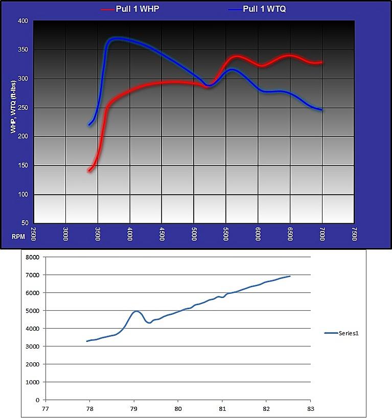

Here is a snapshot of a 'slightly' slipping clutch at peak torque and a graph of the RPM curve below. If you have a slipping clutch, it beyond obvious in a dyno simulator. I looked at your 3 logs and you definitely didn't have any slipping in those 3 logs.
lol ya mine def didnt do that.. when is that gonna be rls'ed? that looks fun

Its a never-ending endeavor lol. The kid helping me wants it done before MOD'10 (Mitsubishi Owners Day) in New Jersey this year but IDK if there will be enough beta testing time. We'll see I guess. Thats just a snapshot from my excel alpha testing program, the stand-alone looks a bit different
