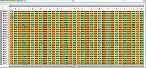

Ok cool,
So i went 4 down on the Y axis and 1 across on the X axis
Orginal value were FFFF, so i entered in 0x840B
Does that right - i've attached a pic of the edited mut table
Old Dec 22, 2010 | 10:28 PM
philr8's Avatar
Joined: Feb 2009
Posts: 245
From: NZ
no youve done it wrong, go to MUT41 (it has 8099 in it now)
Enter =0x840B save and flash to car
Old Dec 22, 2010 | 11:07 PM
nonschlont's Avatar
Joined: Mar 2007
Posts: 1,760
From: Ca
ya, where u have it isnt actually column 1. Change that back to FFFF and look at the column headings. U want to change MUT 4, column 1
