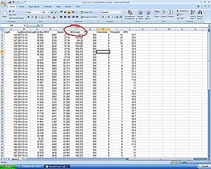

Can someone please give me step-by-step instructions on how to log 2byte load with mitsulogger v1.6 beta 3. ROM ID: 88590015
I attached part of my log for you to look at.
Attached Thumbnails 2byte load/Mitsulogger-untitled.jpg

Add these lines to your requestID.xml..
Code:
<Request LogReference="requestID00" RequestID="00" Eval="x" Unit="INT" Logged="y" Response="2"/>
<Request LogReference="requestID01" RequestID="01" Eval="x" Unit="INT" Logged="y" Response="2"/>
<Request LogReference="2ByteLoad" RequestID="FF" Eval="((256*requestID00)+requestID01)*10/32" Unit="2byteLoad" Logged="y" Response="2"/>
