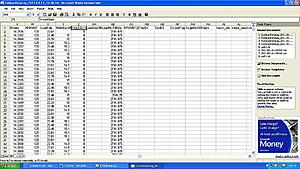

i followed the steps.......this is what i get.
2741.875 all the way down. car was sitting at idle, i dont know if that matters.
Also, im pretty sure i have the latest version of ecuflash and not 1.3 as the directions show. Would that make a difference?
Attached Thumbnails Is this right? MUT 2byte/Evoscan-testlog.jpg
