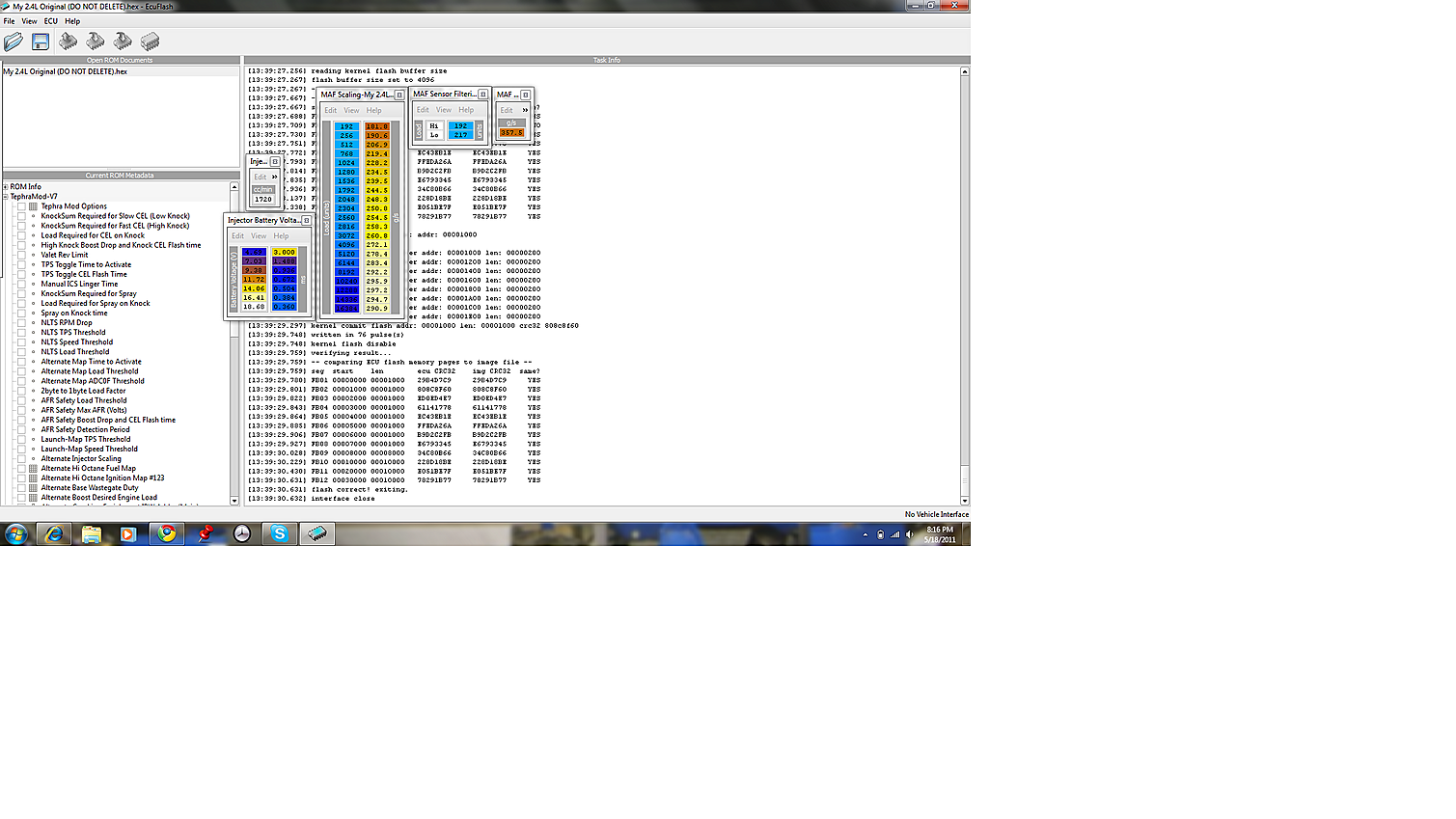

Ok sorry it took so long but i was waiting for my tactrix cable in the mail.
I am still having the same issues with my car and that code.
I attatched a screen shot and i am running tephra v7 rom id 94170715

Old May 19, 2011 | 09:06 AM
stunt2's Avatar
Joined: Nov 2010
Posts: 753
From: Georgia
Originally Posted by EatSleepBoost
Can you explain a little more on how you want the open loop load values to be changed?
set values in all tables - say at 10, instead of 88.1, 60 etc.
Old May 19, 2011 | 09:10 AM
EatSleepBoost's Avatar
Joined: Jan 2008
Posts: 971
From: Mass
hm i will check when i get home but i don't believe i even have those options on my rom. Do i need to copy and paste more info into my xml file for my rom to add the "global fuel settings" if i do not have those options currently??
if so do u have the appropriate xml patch
