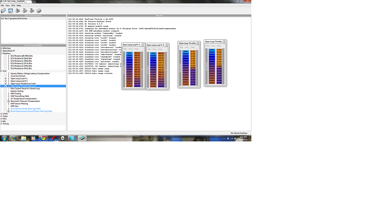

the screenshot is from Tephra V7 rom
if you have the standart rom, table names are still the same, they shoud be located in category "Fuel"

yea i have v7 as well but my values look different and are named different for the throttle. iv attatched the screenshot
