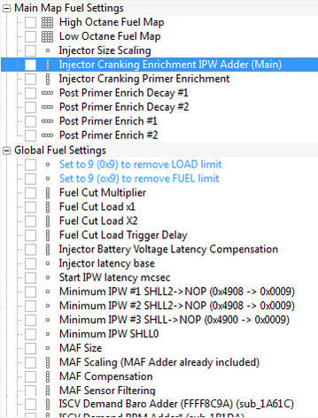

I've read mfred's post on advanced fuel control, but it doesn't seem to be defined for the 9410715 rom yet, as far as I've read. Do I need to change roms to get this defined? Here's what I have available with regards to injectors (is the name different?).

Whoops saw your post a little more clearly.
Yes thats the right table.
