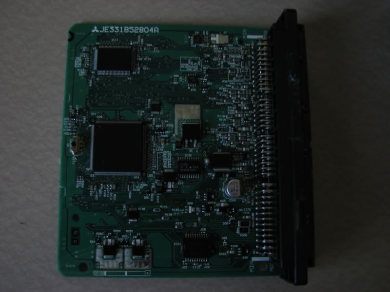

I just bought what I was told was a 2004 Evo 8 ecu, but the part number on the case is MR560648 which seems to be an Evo 7 ecu. I bought this to put in my 1g dsm and already have built my dsm to evo ecu harness. Will I be able to flash an Evo 8 Rom and tune it like any other Evo 8 ecu, or should I get my money back and keep looking for an actual Evo 8 ecu? I compared the pinouts, and all the important pins are the same.

it is an evo7 ecu ,why give yourself hassle , just use a 7 rom like 90550001 most popular one and tune that. if you want a pinout for it let me know il send it on

Huh. Well, that should have been obvious to me. I guess I was so fixated on the "Evo8 ECU in a 1G DSM in the works!" thread, that I didn't consider using anything else but an Evo8 ECU. Will the Evo7 rom have all the tunability and features that an Evo8 rom has?
Thanks for the suggestion. I could use the pinout if you have it available.

yes all the features and theres a v7 big maps
http://www.lancerregister.com/showth...ht=ecu+pinouts
