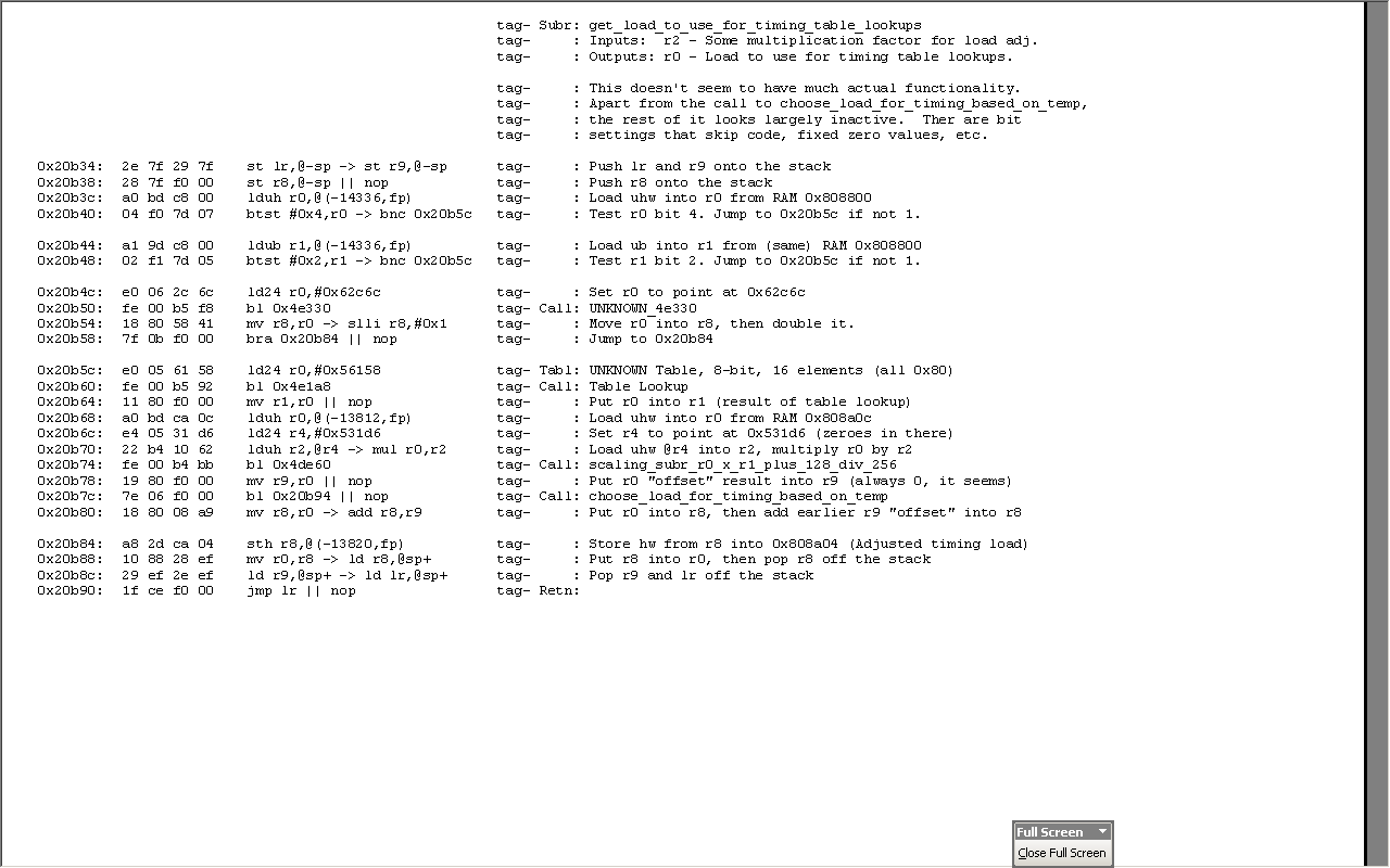

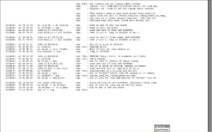

Here's my first stab at learning M32R assy... yes, welcome to stream-of-consciousness commenting...
(looked better as an image - tabs are impossible to get right in this format)
What's the usual standard for assy commenting? I couldn't recall, so I just used an easily replacable "tag-" string.
I'm already putting together a list of interesting stuff to look at and test when I get the chance, like:

0x808a0a - A differently scaled timing, possibly.  Lower level.
0x808a3c - Another, alternate scale internal timing, apparently.  Lower level again.
0x808a3e - As above.
And as I'm still getting up to speed, believe none of the above! I'm not yet able to really tell the difference between the RAM area being used to store useful stuff, and the "scratch" area that's just used-and-reused for any old gubbins. All in good time...
But that 0x808f7c "Baro comp load" is a new one for me, and would be a great find, if it's right. Can't check right now, though - don't have my car! So all I can do is meander around its "residual self-image".
Rich
