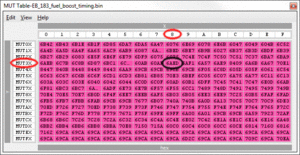

Open your copy of evoscan and check the "requestID" for your OMNI3Bar. That will tell you what address in the MUT table it is getting it's value from. After that check your MUT table to see which address it's logging.
For example, my requestID in evoscan is 38. So I go check my MUT table to see what value is at MUT38 and see that it is 6AED:
Once you know both your requestID and the MUT table address it corresponds to :
1- Confirm that the MUT table address is the correct one. Comparing with a stock rom will answer that question.
2- Confirm that the requestID is the same as the Boost (MDP) and JDMMAP entries in evoscan. Since evoscan isn't rom-specific, they should all be the same as mine (38).
If both of those things check out correctly, then I'm not really sure what the problem could be, sorry! Hopefully someone else will chime in with more advice.
