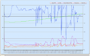

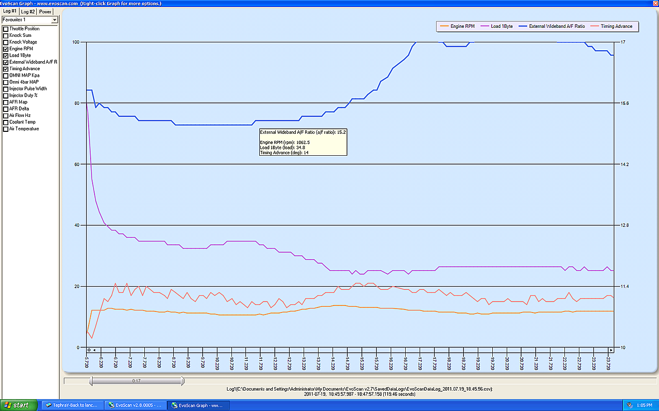

I'd like some guidance on my final remaining tuning "issue". The car runs great when warm, and at all speeds, just not when cold. I've attached what basically happens on a cold start in an image file. AFR does okay for the first few seconds, idle is pretty high, and then as idle comes down after the initial start over 3-5 seconds, the car either dies, or sputters and requires a tap on the accel to get it to idle okay. Then, over the next minute, it idles lean, until it warms up a bit, and then runs fine.
I've disabled warmup ignition retard (but tried with it on), the EGR (but tried both ways), and tried adjusting MAF comp vs coolant temp to resolve the issue. The other thing I'm not so sure about are the ISCV steps, I don't know how to tune them exactly, I've just used trial and error of "if it's idling too high, reduce that temps step, if it's not able to stay idling, increase until it can".
Any advice on ISCV and/or the lean idle would be very much appreciated. I tried with the Speed density 2.0 9653 rom, which has that entire timing map for warmup, and I didn't have an issue with idle warmup (there was bad jitter though, so I had to switch back to 9417 2.0SD).
Thanks

Other thing I noticed is that when warming up, my AFR is lean below 2500 and decent, like 14.7 to 15 above that....does that point to anything? I run in open loop all the time.
