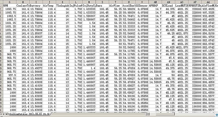

88840016 2 byte load
the 2byte seems uncorrect.anybody help?

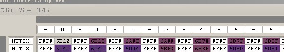

the mut table have been changed.thanks

log map cut

Check address of MUT table in your xml, correct address is 377f8 and IIRC it was wrong in some old xml's in case of 88840016.

thanks ,i tested it this afternoon,the load,rpm,airflow log normal.but the load touch 300load,it seems too high.it means over load?
if i install cam,turbo kit.it will over stock map 300load?
thanks
