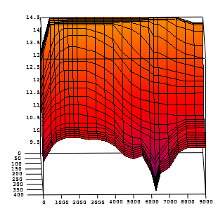

What should I check to be the issue? No matter what I add for fuel there it wont go away, could it be a faulty wideband? I'm not getting a misfire there either.

Here's a screen shot:

If it's a single pump system still it could be overrunning the pump. 330 load seems a little low to be running out of fuel, but It's possible. what's the IDC at?

I'm having a similar issue with my setup on pump gas so I'm curious to see if you get this resolved. However, I have been able to correct it for the most part by adjusting my fuel map in that area. The only problem is that my fuel map looks like someone dug a hole in the middle of it and it doesn't look very pretty, which makes me think that it could still be a mechanical issue.

I actually just had this happen for the first time too. Its 'tunable' but very uncommon. Zero boost leaks up to 40psi, DW300 fuel pump with MSD boost-a-pump and fuel pressure is solid (checked with gauge). ID1000 injectors at a max of 95%IDC (resistor pack bypassed), running 96530706 rom. The only thing we haven't tried are new injectors thus far.

This is pretty much how my map looks, although the drop isn't as drastic.
