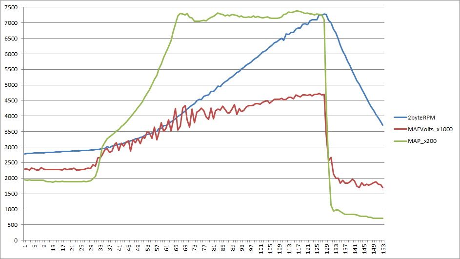

I have to make sure that this issue occurs from either some kind of a hardware fault (corrupt MAP/MAF sensor, etc) or ECU settings.
As my opinion, this is not sensor fault. Looking at the pic, MAP and MAF sensor seems to work well. ( and There is pulsations of the intake air around 3000-5500rpm by FP RED compressor surge...I think. ) So I think this issue could be solved by correct tune.
Could you look at attached pic and answer me? Any different ideas? Thank you.

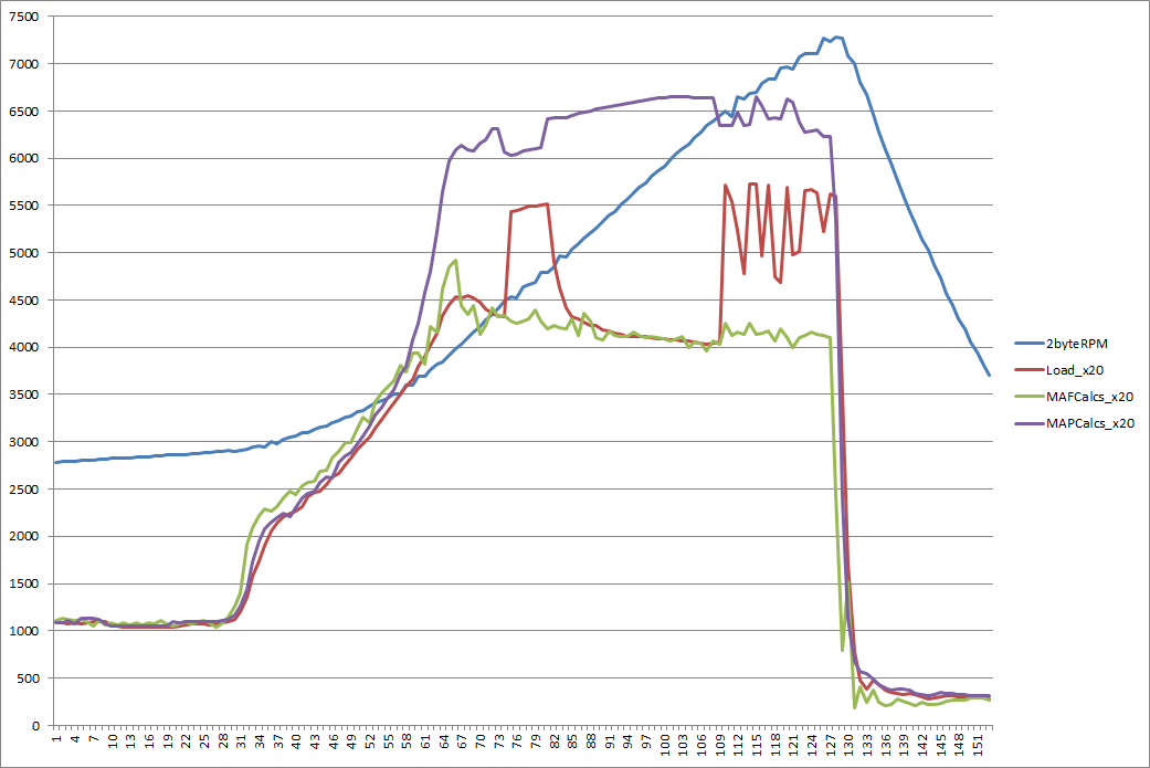

You have access to the MAP_Calcs and MAF_Calcs..
Try logging them and posting a picture.
that should narrow down which sensor we need to look at

Oh, I see... seems ECU does some sort of interpolation between MAPCalcs and MAFCalcs. Very smart way, thanks so much tephra and Golden!
From the log and pic attached(with much increased 3xMAP tables as an experiment ), while pulling my car, the ECU was using value of MAPCalcs as Load until 3500 rpm. After that, Load was going back and forth twice between the MAPCalcs and MAFCalcs.
Ummm...probably I have to define both the MAF Scaling and the 3xMAP Scaling properly by myself. But so far, I have no knowledge about how one can create MAF Scaling and MAP Scaling.
I found some articles written about scaling a little. but couldn't find HOW-TO thread about creating both MAF scaling and 3xMAP scaling.

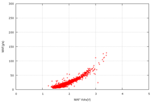

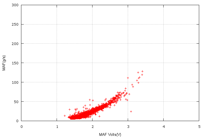

I might have found a way to caluculate and plot actual MAF like data vs MAFVolts curve from a log.
My formula for caluculate MAF(g/s) from an EvoScan log is : ((((( 28.966 / 22.4 ) * ( 0.068046 * MAP ))/( 1 + ( 0.00367 * ( 5 / 9 * ( MAT - 32 ))))) * ( 1998 * 0.001 )) * ( 2byte-RPM / 2 )) / 60
For calculation, I use 28.996 (g / mol) as average molecular weight of dry air.
Attached Thumbnails a Load plummet issue-plot-calculated-maf-vs-mafvolts.png
