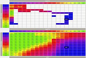

This is first go and slightly adjusting fuel map since I got WB logging via ECU to EvoScan, Just looking for some critique, criticism, praise or handy's if offering. No but for real my real question is about 5000-7000 range is 12.1 too lean? do I need to keep dialing in? I seen most peoples around 11.1-11.9 or so. Thanks
Load hit about 250 with basic bolt on's around 22.5 PSI of boost peak and tapered to around 19 or so.

jpeg kinda hard to read so I tried to use png below

It is not lean for e85, but for pump gas I would tune for 11.5

Like Evo8426 said, for pump gas I would aim for mid 11's at that rpm range for a street tune. For a race tune that will spend lots of time at that rpm (road racing, auto-x, etc) I would shoot for low 11's.

Thanks peps I will keep working it.
Next may post my timing map, to get some insights as well.
