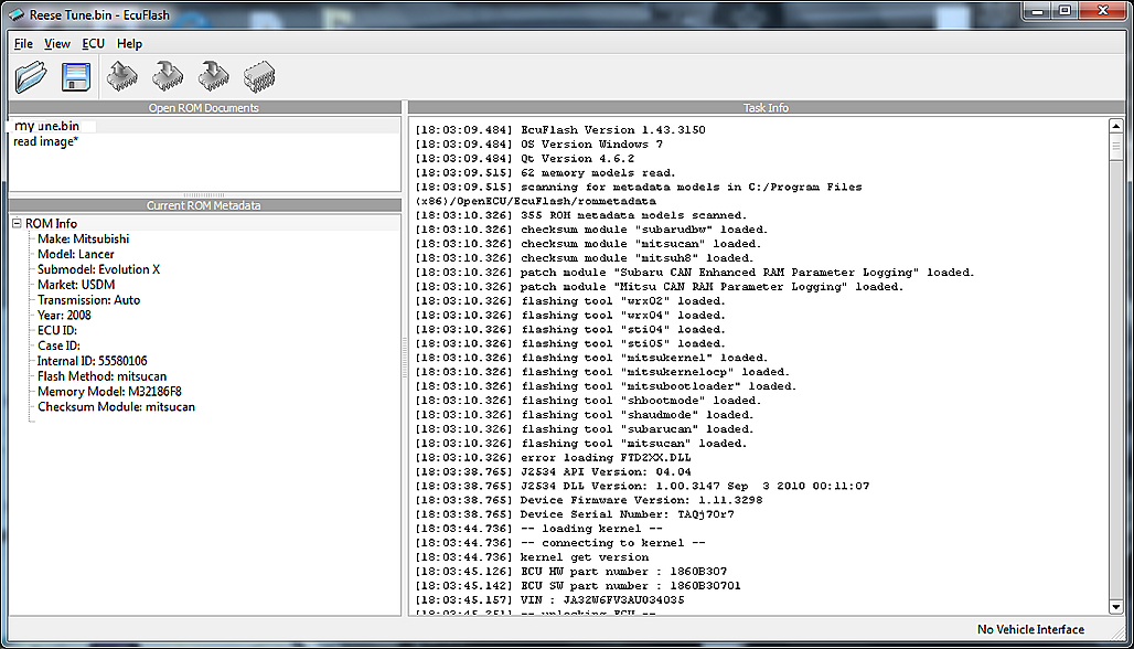

Hello EVO peeps...Today my tactrix cable arrived (stoked). I downloaded the current software from evoscan for my evo x v1.43 i think and did the firmware update for the 2.0 cable. The I follow Merlins instructions for the first time ecu rom download and was able to get the rom from the ecu but it came as a bin file and I cant seem do anything with it. I dont have evoscan yet but I dont think that matters. i have a 2010 x se with a tune... Please

This is the page that I get trying to find the ROM ID goto address 50020... Which is the 8 digit ROM ID starting at 50020A? Am I correct to read it as 00 55 58 55?
Doesn't seem to make sense?
Am I on the correct path in that I'm trying to find a definition for this ROM so that I can read it as a XML file?

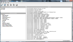

This is where the GOTO 50020 XVI32 search brings me...

I stumbled onto it...
OK, I was able to open my pro tuned ROM and compare side by side values with Tephra XMOD V1. Pretty cool, now I need to get my evoscan and start logging to dial in the LTFT. Since I have dual maps, do I need to do the alt map start (acc on pedal to the floor) and redownload the ecu to read the pump gas map? Or can I find in somewhere in the metadata tables that I previously downloaded from the ecu?
