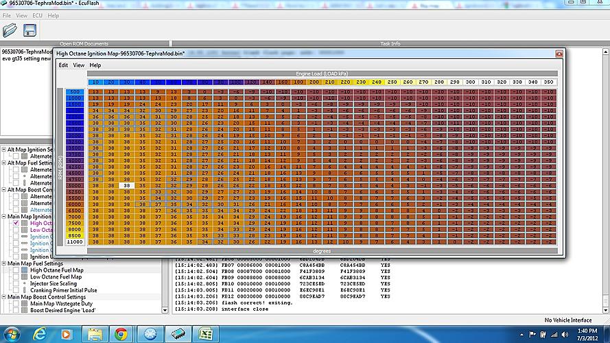

i just copied my hi octane mp and pasted in the map translator and this is the map i got, does this look ok and should i flash it?
and another thing, just below the map translator it says copy the < 1000000 in the last coloum/row what does it mean?

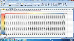

and when i copy/paste my fuel map in the map translator it gives me funny numbers, till 240 load its fuel then its jus ignition maps...

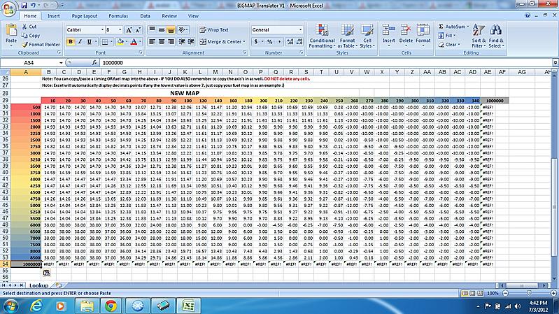

like this....is this right?

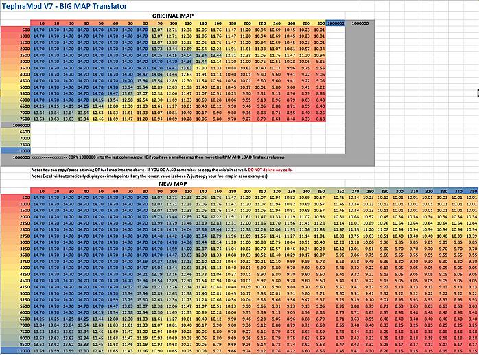

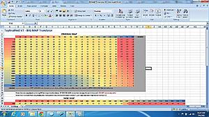

ok i tried everything but it didnt look like that...now im posting a pic of the 300 load cell map, tell me where should the grey value of 100000 go, theres one in the top right corner and one in the left bottom, tell me where both should go...thanks

ill try and word the instructions for you, hopefully i can word it in an understandable way...
1) Copy your RPM column from ECUFlash to the RPM column of the spreadsheet for small map
2) Copy the RPM 1000000 value to the next cell under your last RPM value
3) Copy your Load row from ECUFlash to the Load row of the spreadsheet for small map
4) Copy the Load 1000000 value to the next cell next to your last Load value
5) Clear all the cell contents from their values (the values where you will be pasting your map)
6) Copy and paste your fuel map to the spreadsheet
7) Big Map should be done
hope that clear.

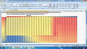

ok i did it now just tell me does this look right?
i know the new fuel map looks right but im not sure about the 4x100000 in the rpm colum, should i leave it like that or change it?

yeah that looks right
happy to help
cheers
