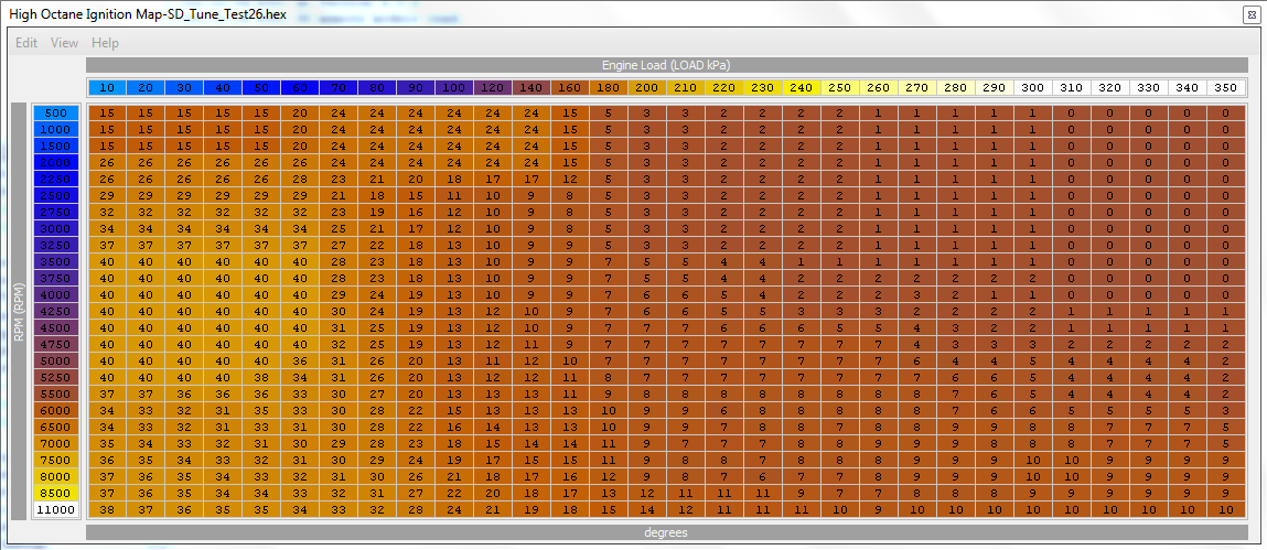

Hey guys,
I have been having a lot of issues tuning car recently. I just went to speed density and seem to have that calibrating near-perfect. The fuel trims look good, and the car drives great!
The issue I am having is that under 250-260ish load anywhere from 5100-6000RPMs, the car starts picking up knock. My AFRs are good, and timing seems to be ok, so I don't know what the issue is. A little info about my setup:
Buschur 2.1L 10:1 motor, BS delete, with fully built head, GSC S2 cams, hand-ported (not flow-benched), Torque Solutions solid mounts throughout, Full-Race T3 manifold, HTA3582R Turbo, Buschur double-pumper, and PTE 1200cc injectors.
No matter what I do with the timing, I can't get the car to stop knocking, and my AFR's seem too good to be the issue. Is my engine just noisy? I'm tuning on 93 oct BTW.
I have attached a few logs as well as my timing map.
Thanks!

Timing looks high for 10:1 and 93 and 26psi of boost. I'd be half of that or less in the lower rpm range, where you are 5's I'd be 1 or 2 normally.

try out the gsc s2 mivec map it think from english posted in the mivec tuning thread. that helped out my knock with gsc s2's a ton. also i agree you seem to have a lot of timing.

The reason my timing is so high is because when I started low, the car was knocking like a bastard! I gradually increased the timing, and this is where my car has been best-case-scenario. Only issue is: IT'S STILL KNOCKING!
Aaron, I tried the map you sent me, but had no luck... Also tried lowering my timing again, and it knocked even quicker...
