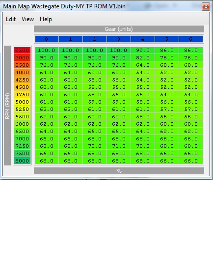

The "old way" Im referring to is that before we had the "WGDC=100%" map, people used the main WGDC to promote spool, by having 100% in it long as possible.
Now with the "wgdc=100%" table, I dont really use the main WGDC map to promote spool. I find that this makes boost more consistent and lessens the chances of spiking over your boost target, due to not trying to keep high WGDC values to promote spool. Here is an example below.
Info - FP BLACK, 28psi from pk boost to redline. 25psi WGA heavily preloaded. That pic was a work in progress, but it helps you get the idea.

After looking at your WGDC map in the other thread, I see your issue now.
In 3rd gear, you have 90% at 3250 and then 65% at 3500, the next cell. That is too big of a jump around the peak boost area. It seems the reason you have it that way, is you are doing it the "old way", using highest numbers in the main WGDEC map to help promote spool. If you just used the "WGDC=100" map then put like 65% or 68% at 3250, I think it would be better.
