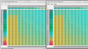

I've tried increasing a degree or two , but I've pulled way more than I've tried to add. Really I was shooting for low 12s at low boost, and I think that may be too rich. If I could settle on an afr number to target that was proper it might help. My sd tune fuel map reflects actual afr which I will post later. I will try adding more timing than originally I started with. I have been fighting this cam and intake manifold upgrade since I installed it 3 months ago lol. Making power seems to be easy but part load tricky. Do you think a leaking bov at part load hinders performance? Greddy type s... Single spring mod.. I'll add the other spring just to be sure. I noticed knock before on my txs rfl when I had it sprung lightly.
Old Aug 14, 2012 | 03:48 PM
211Ratsbud's Avatar
Joined: Oct 2010
Posts: 4,286
Likes: 43
From: Watertown, NY
6 is where im at, getting a 3-4 knock count 2500+ rpm range. 7 is how Im gonna try to fix that. i know it changed a lot of cells in the area, but I try to keep it smooth. knocks were happening at just under boost. map 5 which Iwill not post cause its already overwritten was extremely low timing and sluggish. im still closed loop when im getting these knocks on map 6. Sorry for the confusion. Didnt log on the way home because the knock light was on so much less and I could drive the car so Im going the right direction. I will update. I also need to dial my target AFR in.

HELP my car is going to blow up at .6 psi of boost! Some how this has got to be false? or is my timing crazy off? I really am losing hope , chasing this around like mad.
One thing to note is my front narowband sensor has a heater circuit fault. Its a fix in the works, but i have my doubts of its contribution to the knock of this severity.

Car feels amazingly zippy still get a lot of light accelleration knock 3k rpm. I increases timing since map 7
Knocking at stoich in cl roughly 90-100 load still
Serial gauge reads 15.0

Bump that timing up man! Try something more like this..

Old Aug 15, 2012 | 10:28 AM
charlie.tunah's Avatar
Joined: May 2010
Posts: 836
From: Maine
wow. Thats a very big difference.
