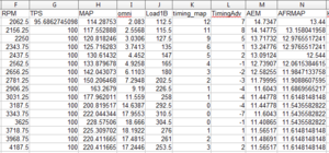

new record right there! look how much off my timing map is! the lowest value in my map is -2 in regions I dont even hit!

Disabled faa10 seeing if that helps

Clearly solved with FAA bit 10 disabled.

Nice. Thats the one labeled "weird timing pull during cruise" right?
Guess that description is wrong. Good find.

Lol yea asked donner about the timing gap and he suggested faa10.
