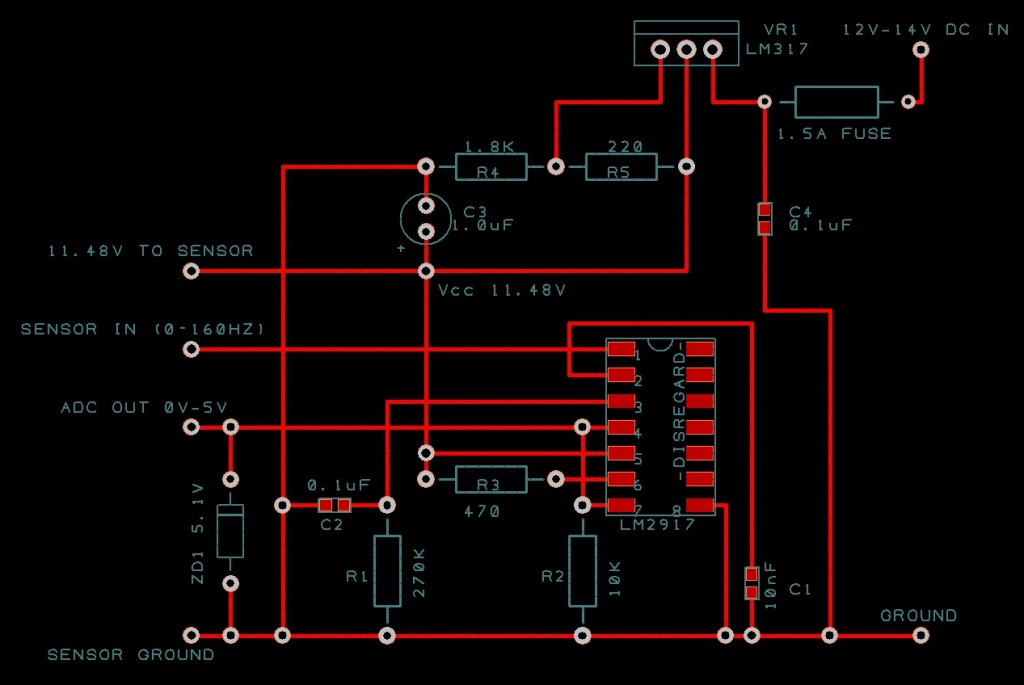

I'm working on a no frills simple HZ to DC converter that has the least amount of components for failure. Also, I want it to be CHEAP. I've been doing some research and after building my JAW 1.04B after almost 4 years, I gained some motivation.
I chose the LM2917-8 and an LM317 as a voltage regulator. I'm no EE by any means, and I don't have a real oscilloscope, but I came up with this based on posted calculations, specs, forum results, and a crude spreadsheet. Call me a Reverse EE ha.
I have 10 pcs. of the LM2917-8 on order ETA a day or three and the "new" flexfuel (previous post) sensor is at the UPS hub waiting for me. I'll mock this up with my own power supply and may build a 555-driven astable frequency generator to "tune" the circuit or see if it is doable (it should be fine). I may just drive the FF sensor on the bench too.
Capacitances and resistances may be off by 10% or so until this is tested. Feel free to breadboard it up if you have the parts and are bored like me over the holidays. The voltage regulation part may not be necessary or maybe the voltage can even be stepped down a hair to fight dropout but this will not supply 12v to the sensor (again may not be an issue as people have driven it dry on the bench at 9v at gotten a HZ output) and create more heat on the regulator.
From what I see on the roms, lower floor and upper ceilings can be adjusted (in case output may range from say 1.4V-4.4V) so this may still work. The design should also be nice and linear.
...or...I'll just buy a ZT gauge haha (but after I test this). Any input from skilled EE's would be appreciated.

Yikes!!!! That's a lot more motivation than I. I don't know that would not want to be able to see what the sensor is seeing. Its helpful to know the the ecu is interpreting the same values of if there is an issue.
Thats where logging will come in handy...
Then we can think about gauges, blinking lights, you know and such. But I wanted to keep the proto-parts under like 30 bucks and I have A LOT of passive components laying around. Like bez (one of the early guys who navigated the EVO's ecu code) said years ago, it's "so my brain won't die."

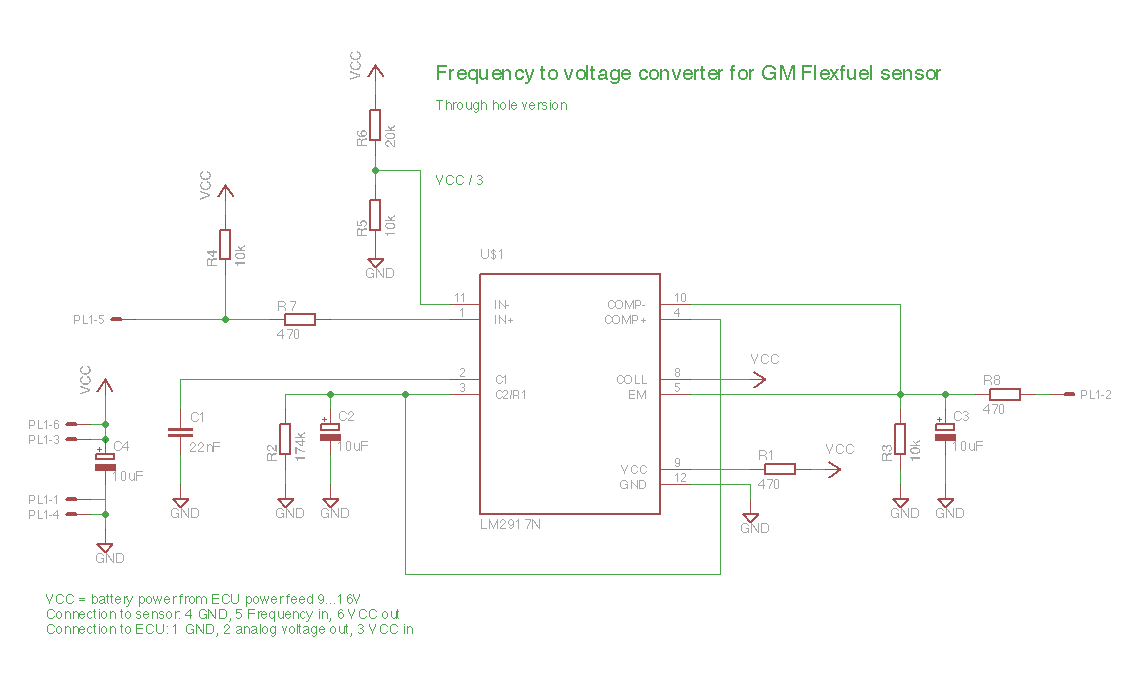

I also experimented with LM2917 based converter some time ago. My schematic did work but it was not completely linear and it's kind of hard to get good output voltage range as there's the 50 Hz offset in the sensor. Also the output stability is a compromise. More filtering offers stable output but slows it down and vice versa. That's the nature of the analog circuit, it's not perfect. However in my opinion it should still be good enough for most applications when properly tuned.
I tried to tune my circuit so that the accuracy and response speed should be acceptable for most cases. Here's the circuit I experimented with. I might still have my measurement results for this circuit somewhere on paper. If I find those I'll post them. I did use square wave from a function generator to simulate sensor output, oscilloscope to verify the frequency and output stability and a high accuracy benchtop voltage meter to measure the output voltage.
I know that Donner is working with the new sensor but it's up to him if he wants to share his findings with us or not. Most important things to verify are the pinout and is the output the same and if not what's the difference?

ast, thanks for the input. the Vout of a 2917 is proportional to the Vin which makes it need a regulator at the least-based on the equations in the manual. It may just be an old design.
The lm331 on the other hand does not care about Vin and seems to be a newer chip. A reg is still a great idea anyways. I have that chip on order too and without straying from too many passive components in the technical example in the manual, I can get a pretty linear output (on paper) from the stock equation almost exactly as the above chip. I dunno, we'll see. I pick up an old o-scope and function generator tomorrow for my idea of having a good time.

LM2917 has built in 7.56V Zener diode. With series resistor R1 in my schematic it acts as a voltage regulator. Temperature has some effect on the Zener but that's also true for most external regulators. This is one of the reasons why a microcontroller with good external DA converter and good voltage reference would be best for the application.

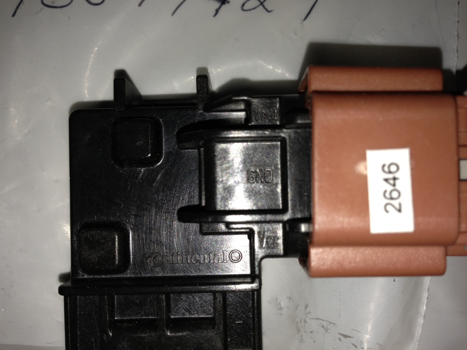

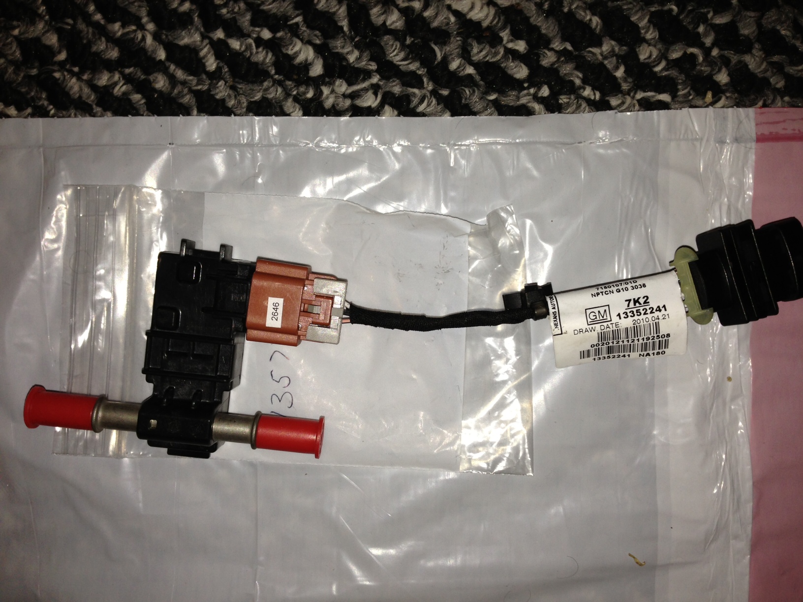

Ok. Don't judge my o-scope. I bought is for 25 bucks yesterday with a function generator and a new probe from Fry's off of craigslist. It's vintage. I'm just learning now and you don't start out with a Ferrari. Just saying.
New sensor and pigtail. Part numbers are in my previous post. Seems to be made by Continental for GM. VCC, GND, and, VOUT are labeled on the casing too!:

This flexfuel sensor *should be a fine replacement for the older units. I will get a syringe and inject fuel into it tomorrow or so and try to keep it controlled and safe for pump 93 and then pump e85 and will list the gas station too using two new jugs. This way people can be confident with buying this thing as a cheaper replacement with their ZT or other units.
I'm still waiting for my IC's but have modeled everthing in LTSpice and have added an active TL082 filter with and passive filter after it (5 bucks in parts lol). about 0.5-0.6s response time. It may be okay, but the models are near perfect linear from 1.6v-4.8v (12.5HZ steps siumlated) and .004v ripple at 50HZ exponentially getting smaller as HZ increase. We'll see if it's usable and works in real life that way or close. Everyone else, by a ZT guage or equiv and sensor lol.

Do you have a close-up picture of the sensor connector without the harness attached? With the old sensor I used a universal 3-pin connector that I can get locally. It required just minor cut to fit the keying used in sensor, otherwise it did seal and fit perfectly.
One thing to note is that at least the old sensor was transmitting fuel temperature by varying pulse width. Pulse width also affects the analog circuit a bit as there might not be enough pulse width to charge capacitors at very low fuel temp. So if you can adjust pulse-width in your function generator, test with different widths. If I remember the pulse width range for the old sensor was 1 ms - 5 ms.
