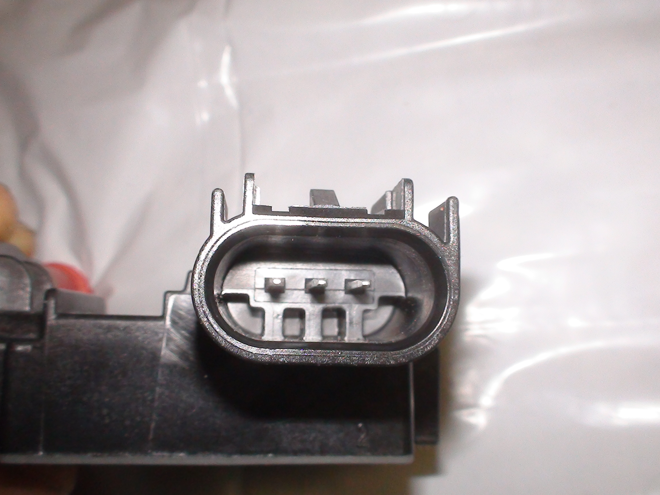

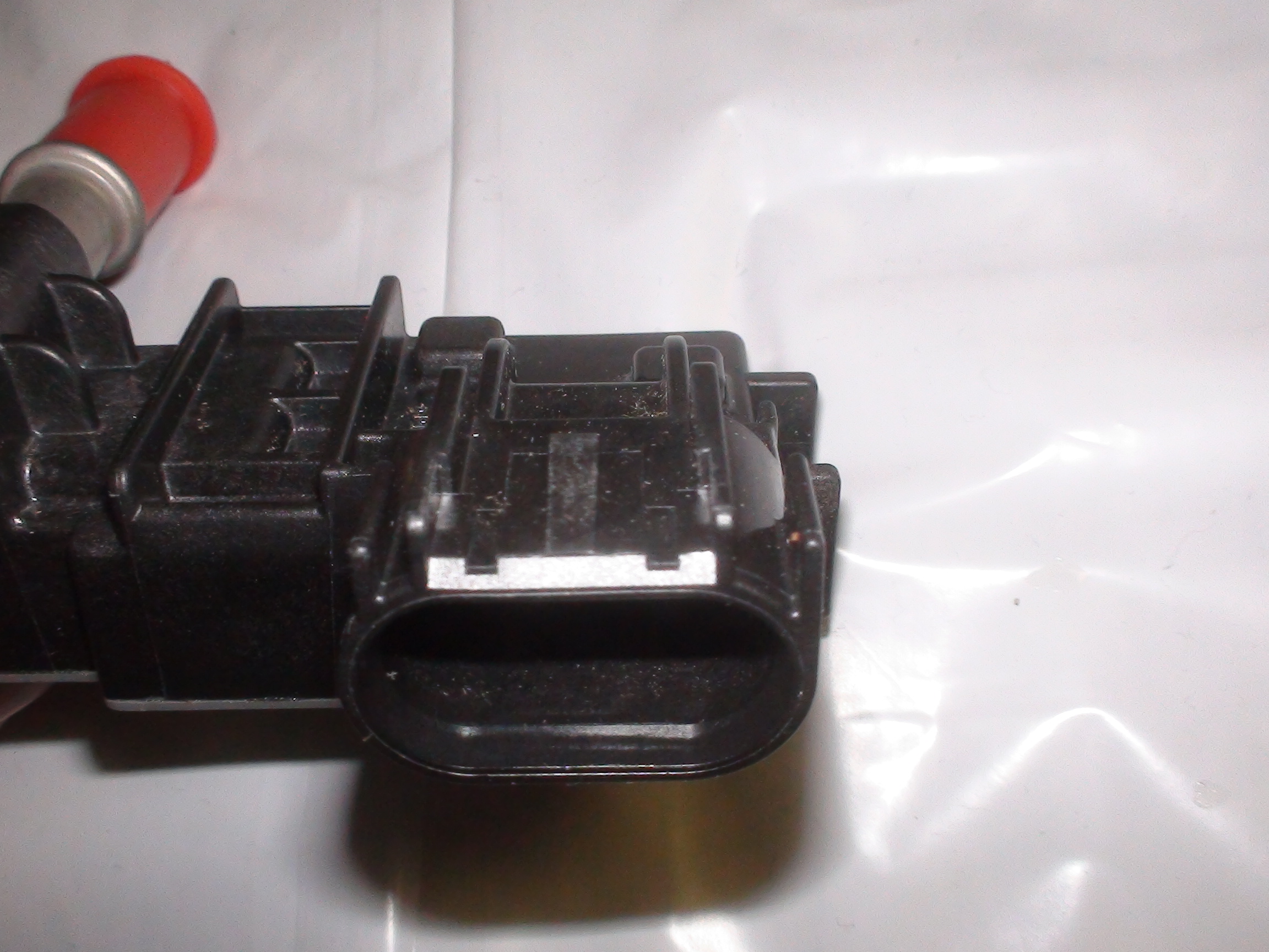

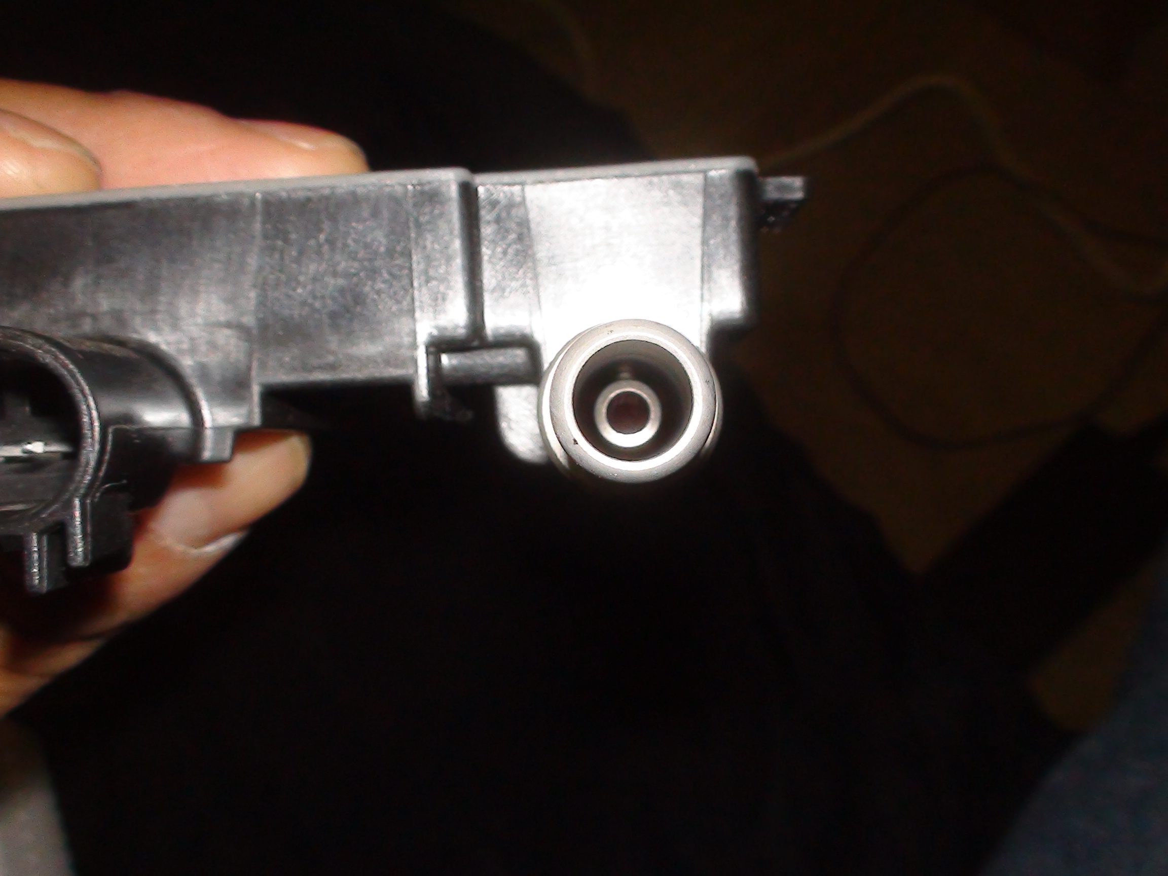

General connector/element pictures. I can measure if you need.

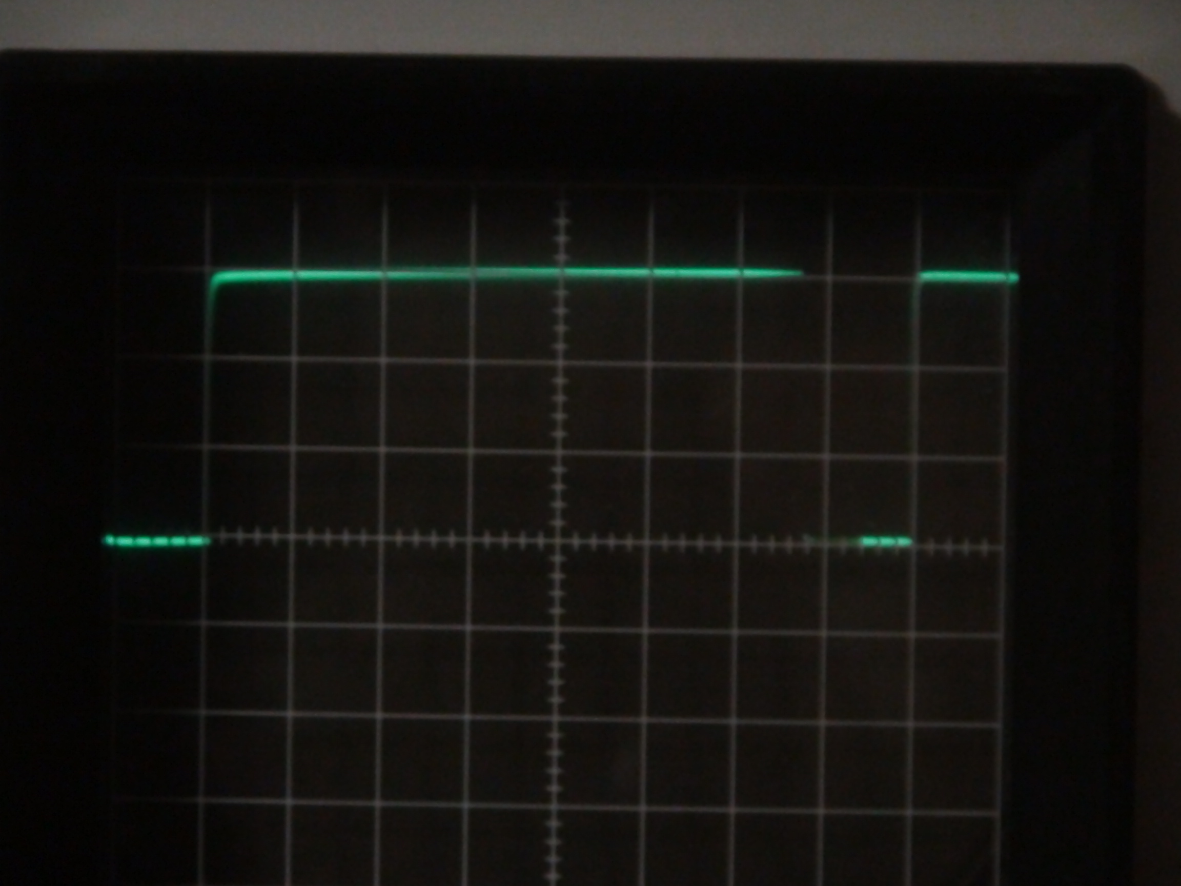

Initial results with Pump 93 and Pump E85:
All tests were done with the same voltage/resistance configuration as my previous post. Different end caps were used for each fuel as well as syringes and graduated cylinders. Fuel was set in jugs at room temperature of 70 degrees over night. The sensor was washed with a stream of 10ml of the incoming fuel before it was filled in a vertical position.
The sensor was brought back to control offset of 50HZ before and between fillups. It basically went to to exactly 50HZ when the fuel drained out. The microprocessor inside the sensor does it's job very well and there are no spikes, sawteeth, etc. Just a super smooth ramp up or down in HZ. Thats why I don't see the need for yet another programmed controller after this but whatevs. When you *think about sneezing, an analog scope pics stuff up (exaggeration) in real time and there was nothing.
Pump 93:
Edit: See attachments: pump93
2 ms/div
8 divisions
62.5 hz

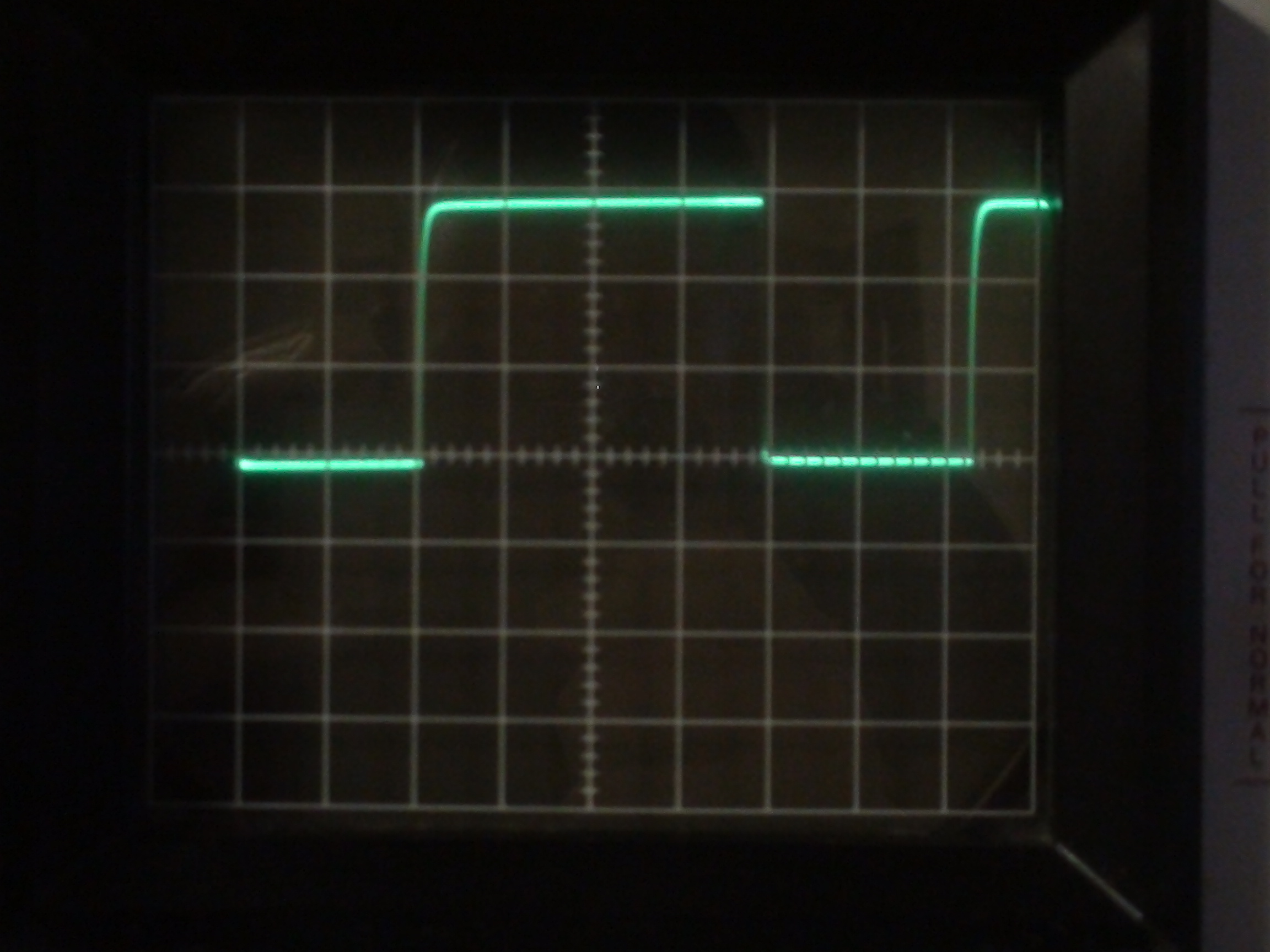

Pump E85
Edit: See attachments: E85
1 ms/div
7.1 divisions
140.625 hz
*Expect a modest 1-5 hz error level. Sensor should be a great replacement for the pricier models. I'm still waiting for my stuff dammit.
EDIT: Added another test.

"Pump 93 (E10)" 20ml and "Everclear" 16ml
Edit: See attachments: E50
2 ms/div
4.8 divisions
104.166 hz

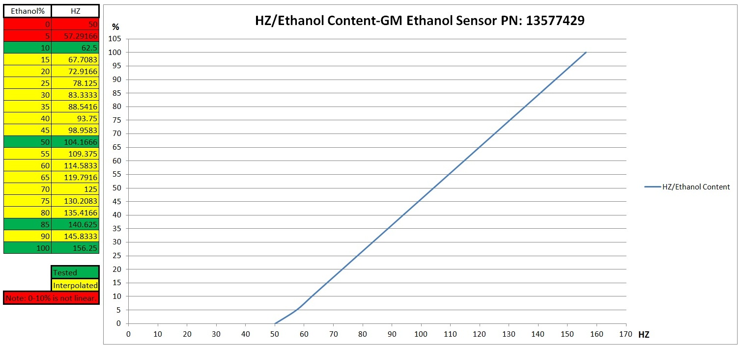

EDIT2: I did a 50/50 mix test (20ml "pump 93" and 16ml "everclear") and swirled it until completely uniform. Also, made a quick graph. The ramp from E10-E100 is eerily linear and EXACT to my findings! This would mean I do have E85 at the pump and E10 at the normal 93 pump. I'm pretty sure it's spot on. Note E0-E10 is not linear--may have to do with the offset compensation.

3/8 od on the in/outlets. A 3/8 fuel line slides on perfectly.
