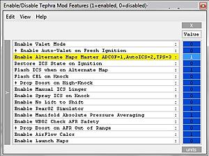

I bought a J_o_t (dyno tech) map switch harness and hooked it up as instructions said... Dont work yes in tephramods it is turned on, thresh hold is a tad over 3v

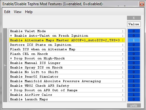

What value did you set the Alt-Map switch option to in the 'Enable/Diasable' TephraMod list? It should be set to 1.
-Jamie

Yes it is set to 1. Threshold is 3.04 V as well.
