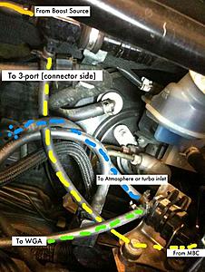

Is this correct as far as running the vacuum lines?

Edit too much irrelevant info . Yes I believe that is correct , unless the bcs goes before the mbc. I think it would work the same though

Gotya. Yea i did a search and couldn't find much info on it for the Evo guys, let alone a diagram for it. Figured I'd start a thread on it. Anyone with pics of there setup please post. Thanks
