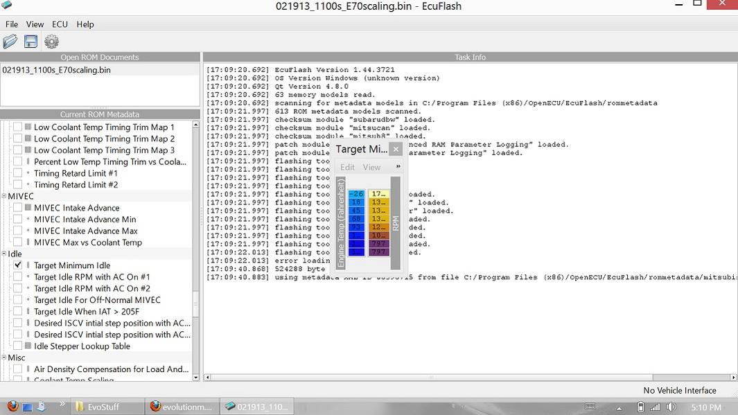

I know its probably stupid and has something to do with Blobbits in the scaling but cant seem to figure it out. My new laptop is smaller so making all the text bigger pushes values out of the cell and now read "X..."
Whats the quick fix for this?

Ill get a screenshot of it tonight when I get home. But basically if you open up many of the tables, the values in the table are cut off by a cell that's not wide enough.

Ok, here it is. A good chuck of the cells do the same thing, values get cut off and there isnt really any way to read them.

looks like you just need to change your screen resolution

That would make everything bigger including the numbers. I can change the text font but I have a 13" screen and things start getting real tiny squeezed down that small. I had the same issue with a few cells on my old laptop but just dealt with it, now too many important tables need larger cells so I gotta figure it out.

I have seen this using the latest Ecuflash 1.44.3. Happens on many different ROMS 8, 9, X that I have opened.
Some just display XXX others look like the posted pic /\/\
Im running Windows 7 Home Premium on a Sony Laptop less than 1 year old
Screen resolution can go to 1900 x1200
will look to see if changing screen resolution fixes it

OK just tested all the available resolutions form 640 up to 1920 x 1080 All of them display the same issue.
Something is not right in EcuFlash 1.44 ....

I have seen it when using a win7 platform and the same file display fine on XP.

Forgot to add this is running on Windows 8.

So we are seeing it across different Windows versions as well as different computers..but not on win xp
Can this have something to do with the .net frameworks or maybe how EcuFlash is placing the screen calls off to .net?
Can everyone list the .net versions they are using?
My Sony laptop is using .net Frameworks 4.0 client profile dated 2-24-2011
