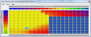

Everything works well except that AFR does not follow what defined in the high/low octane fuel map. This happens to the alternate map as well.
I tested by putting 7.4 to every load/rpm cell and the car idle like crap. This means that I am modifying the right table/address.

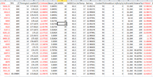

However, when tuning the car with some boost, the AFR does not go down. I also tested by putting everything starting from load 100 - 200 to 7.4 but the actual AFR (reading from MTX1) was some where in 13s.
What i found out is that when I logged the target AFR (AFRMAP) from evoscan, the target is something in 12s which i supposed to see 7.4 as my map is all set to such number.
Any idea where else to check? Attached is the bin file. Please help..

injector duty cycle should be moved down in the list and logged below pulse width for the calculation to work in evoscan I believe, it's definitely true if you use openport 2.0 autolog on sdcard, if you don't you end up with zeroes like on your picture
