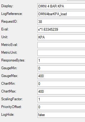

How do i log kpa?
How come 100 kpa is 14.5 psi when converting?
So is 100 kpa what we live in? Baro? Atmospheric pressure?
And 200 kpa is 30psi but subtract the 14.7 atmoshperic pressure which leaves me at 14.5 psi of boost?
Right or wrong?

Originally Posted by 4b11slayer
How do i log kpa?
Right or wrong?
Thats right, KPA is an absolute measurement starting at 0 pressure, like in outer space. We don't live in a vacuum so it starts at what ever the atmospheric pressure is at your location or at sea level its 1 atmosphere = 1 bar = 100kpa = 14.7psi (relative to 0 ). Thats why you need a 3 bar map sensor just to ready up to ~29 psi instead of 44 psi, that first bar gets eaten up by measuring the atmospheric pressure. Also that 1 bar of atmospheric pressure is how N/A engines work.

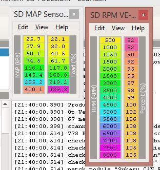

Here are my current settings.
Old Jul 28, 2017 | 08:50 AM
mines5's Avatar
Joined: Oct 2010
Posts: 868
Likes: 23
From: Streets of willow
Lower the right hand side column of your MAP VE till 61 Kpa and you will see your cruise afrs getting close to 14.7..

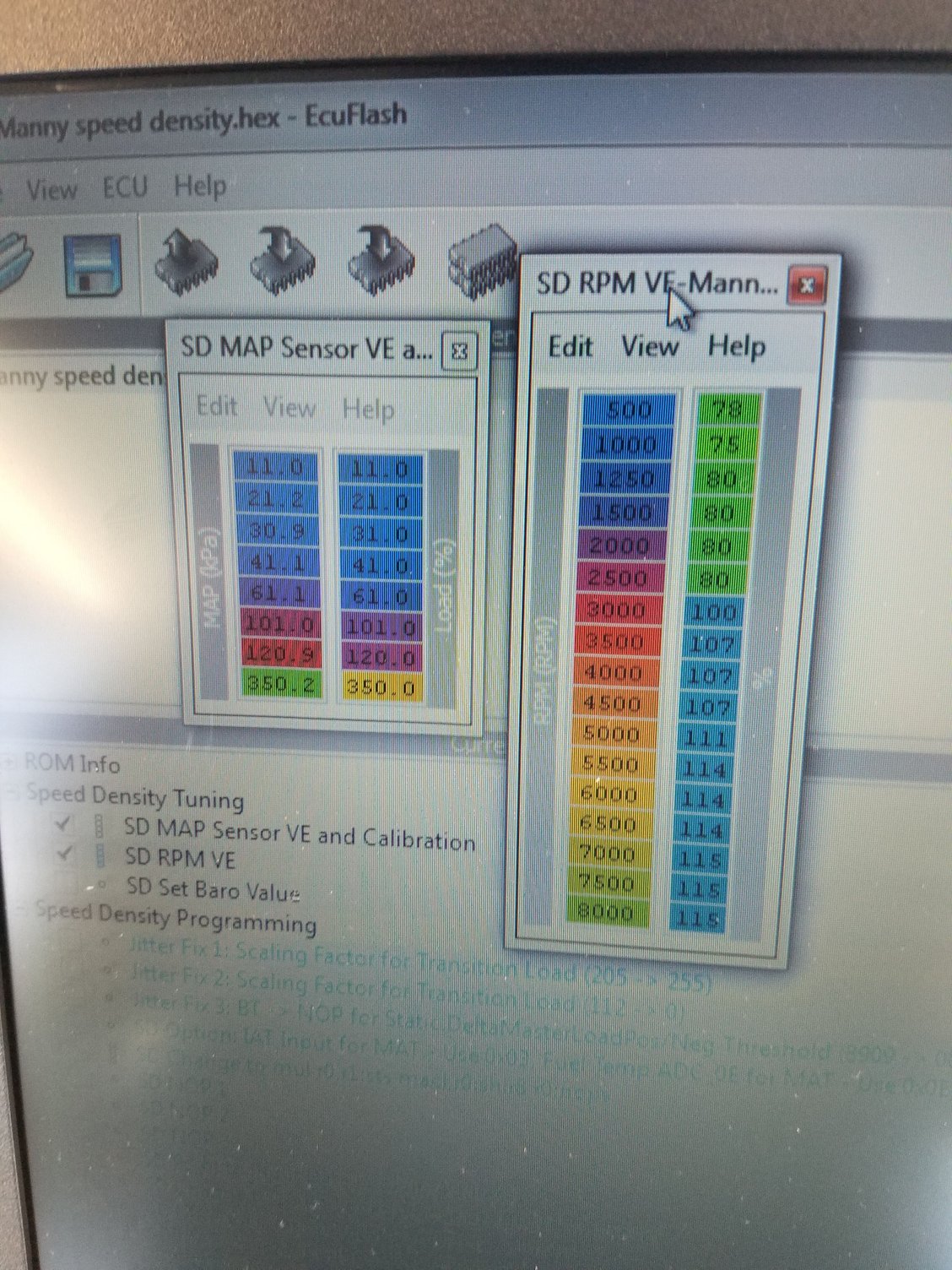

This is for FIC 2150s i tuned.
Look at this photo and refer to the above posts.
Old Jul 28, 2017 | 10:13 AM
4b11slayer's Avatar
Joined: Nov 2015
Posts: 1,787
Likes: 89
From: Santa Ana
Why did you adjust the MAP KPA column? Instead of just the LOAD %?
