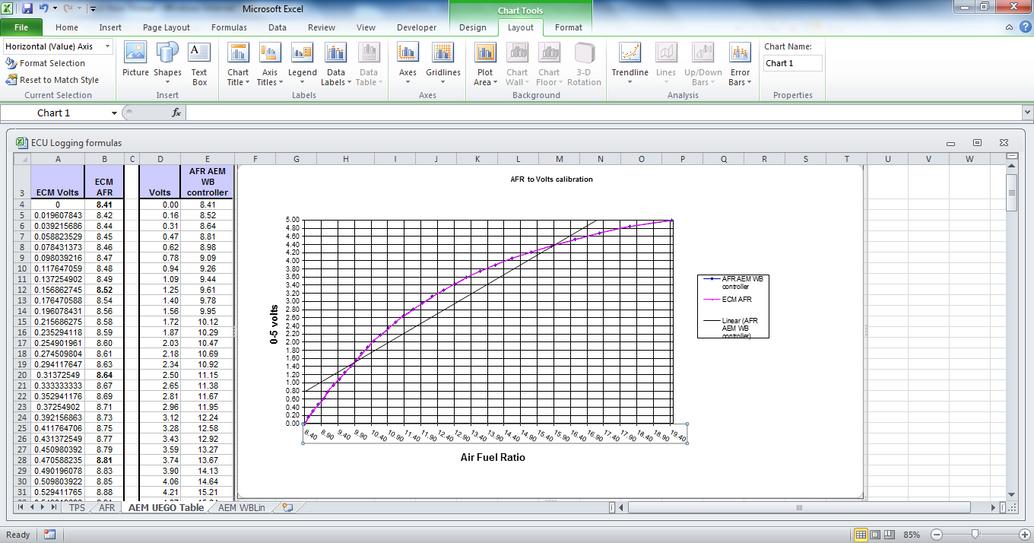

I recently hooked up my AEM in-line WB O2 and have it running via pin 75 directly to EvoScan. Reading loooked odd so I started digging around. I found that the signal is non-linear on this model. I found info that other tuning platforms have susessfully logged using polynomial equations:
http://forum.efilive.com/showthread....n-Linear/page3
The equation used is:
((((0.0298)*{EXT.AD1}-0.1826)*{EXT.AD1}+0.4971)*{EXT.AD1}+0.5253)*{EXT.A D1}+8.4433
What is the referance ext.ad1? Is there a way that I can plug this into EvoScan?

I'm guessing EXT.AD1 is the raw value logged by evoscan. So in evoscan you should just replace it with "x"
